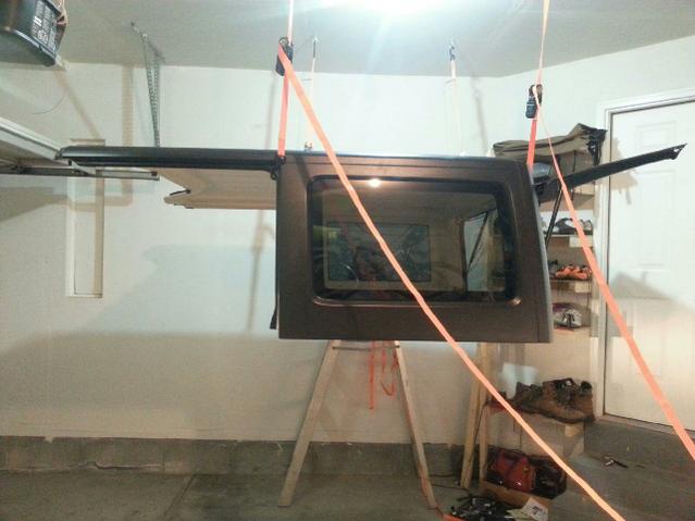

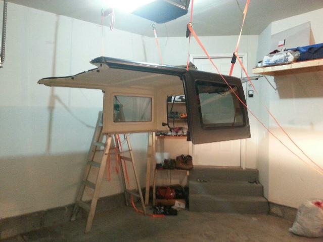

I do this in my garage. It doesn't take up any more space than the Jeep does in the first place. Four eye bolts in the studs, four ratchet straps. That's it. Super cheap, and pretty fast. Back the Jeep in, raise the hardtop three inches, pull out and pull in forwards. Easy, and space friendly.

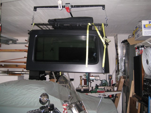

Looks good! I use a racor because I wanted to store the freedom panels above the roof and also use it for the soft top during the winter. I was afraid to put the freedom panels directly on the roof but it would probably be okay. And my garage is not as uncluttered as yours.
