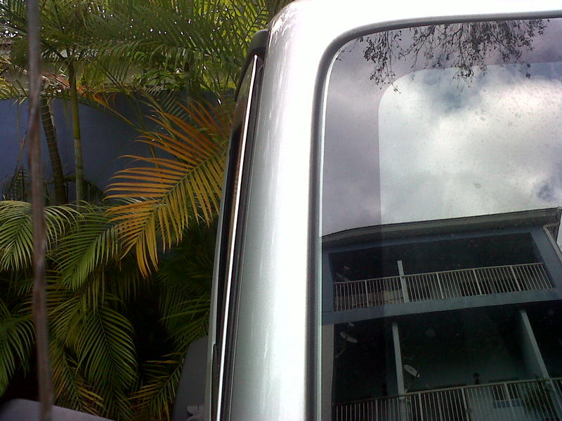

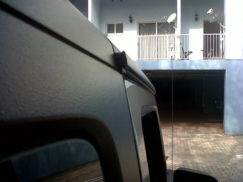

Two days after I picked up my JK, I noticed the pax carpet was damp. So i pulled it up and the white padding was pretty wet, but considering it hadnt rained since I picked it up. My first thought was the AC leaking inside, so i left carpet out the whole week running the AC and heater every time i drove, but nothing - no water.
So reading a bit more, someone mentioned looking at the door seals where it meets the top; i have a hard top. Once i started looking at that, i noticed the top of the door not sitting flush when closed, sticking out about 1/4"; and he bottom of the door also not sitting flush, actually in by 1/4". After some adjustment of the hinges (inside door panel), door seals a lot better. I think its safe to say this could be the culprit.
here are some pics before and after.

Old Jan 28, 2012 | 11:16 AM
MacBeJeepin's Avatar
Posts: 440
From: Columbus, OH
Wow that was not sitting correctly at all. I get water leaks as well, I'll have to see if my doors are seating properly and start with this.

Old Jan 28, 2012 | 11:26 AM
m998dna's Avatar
Posts: 534
From: Whittier, CA
good find ...
Unfortunately Jeep hasn't learned how to mount and adjust doors yet. I hope that fixes the problem and probably the reason some have leaks and some don't.
