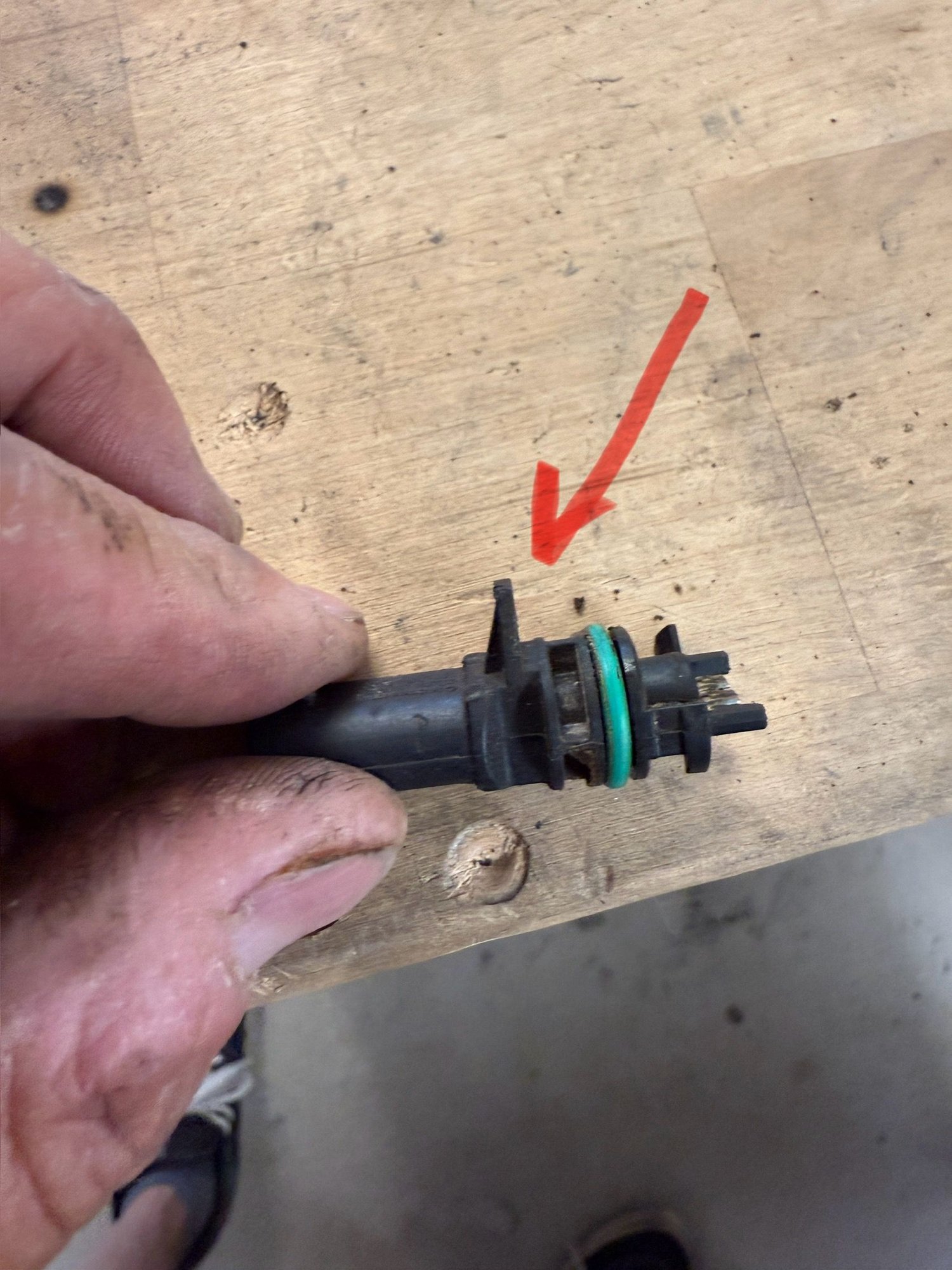

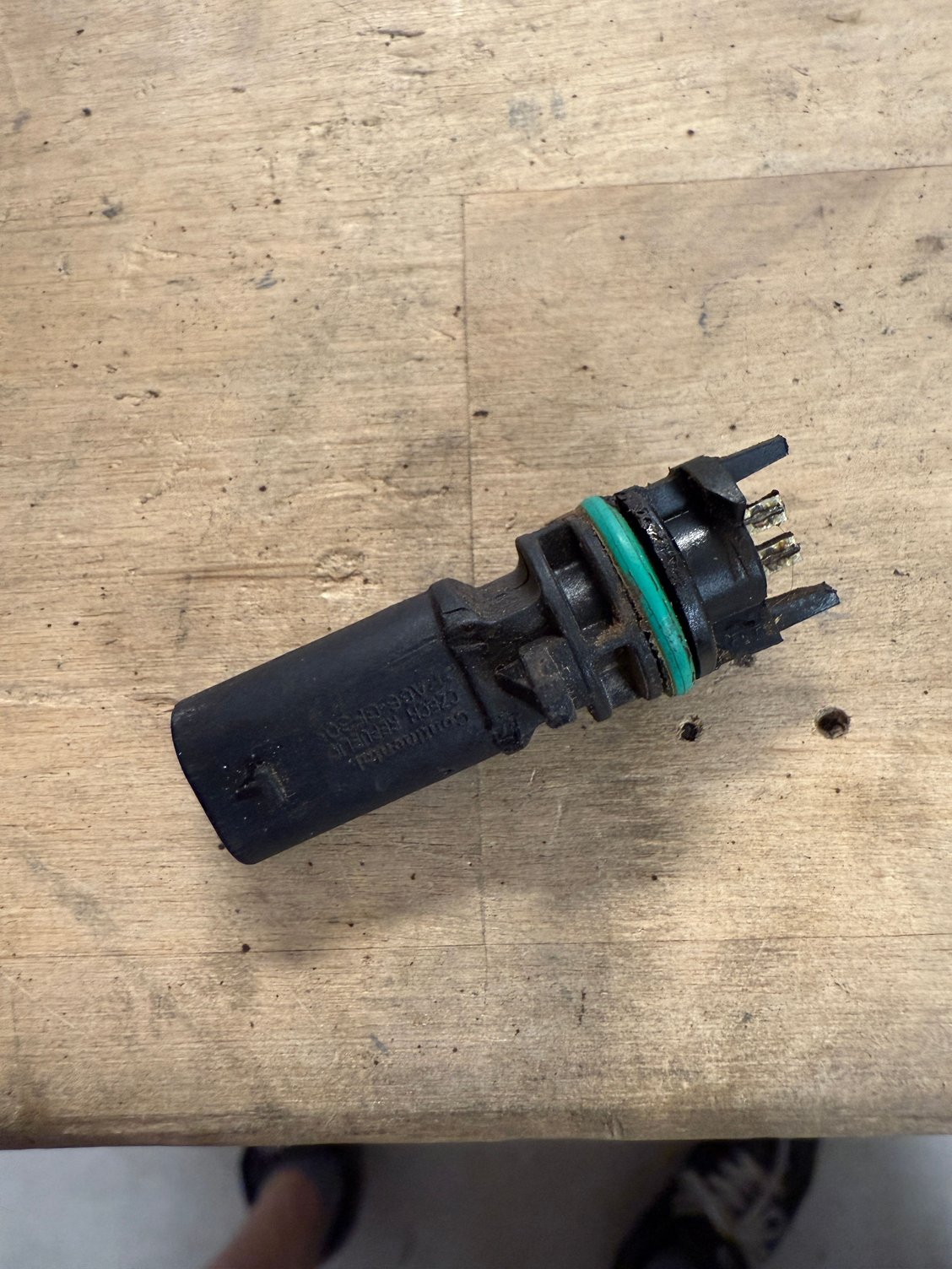

Today I installed a cat-back exhaust and cold air intake. The latter has a sensor plugged into it called the Air Charge Temperature Sensor (Autozone part #SU18256). This sensor has been misidentified in YouTube videos as the mass air flow sensor and by my local Jeep dealership parts counter as the manifold absolute pressure sensor. Based on what I found it is neither and is in fact, the air charge temp sensor. I have not seen or heard this sensor suggested or identified to solve this issue previously. The one I took out of the factory air box tube was bent to one side and while trying to straighten it out, broke one of 2 wires at the tip. It tricky even getting it out of the air tube: it requires prying a tab up and rotating the entire sensor counter clockwise with a pair of pliers.

Factory air charge temp sensor.

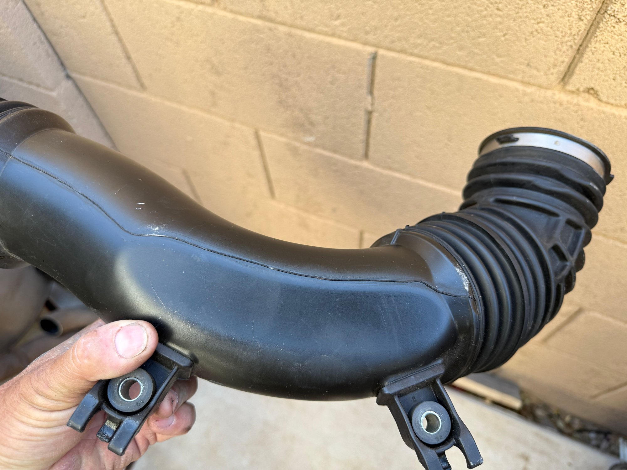

 Top view of the air box tube as it sits in your engine.  The throttle body attaches at the right end of this tube, air filter off camera to the left
Air box tube tipped towards you, the sensor plugs into the little spigot just left of the band clamp.
