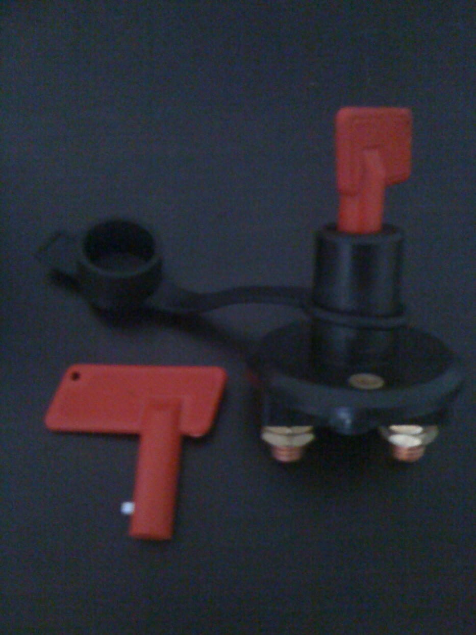

i brought this issue up with my father. he is a mechanic and came up with this idea. he bought this switch key at Napa to prevent theft. what we did is spliced the power cable to the starter, the one going to the battery as you need it to power the starter and turn the flywheel toturning engine the on, we extended some 12 gauge to reach the inside of the center counsel where i can lock it. so i do is just open the center counsel, remove the key, take the key w me, and lock the center counsel. the starter has no power so they cant take it. i also turn my wheels and lock the wheel just in case.
what yall think? it was like a $20 mod
