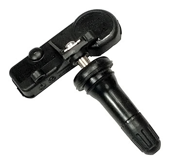

Originally Posted by usmcdevildog
So....then is there another way to tell if I actually have the sensors besides taking off the tire?
Metal stems! They should be black rubber. (with a brass shoulder below the brass thread under the cap)
The grey (metal stems) were for the pre-2010 models and were replace by black rubber stemmed sensors (of a different frequency for 10-12s. The '13s have entirely new sensors that are not compatible with the 07-12s.
My guess is that if you have sensors, they are not '13 compatible.
The only requirement to recognize new sensors is to drive at speed over 15 mph for up to 20 minutes.
Photos are 07-09 gray and '10-12 black (I assume the '13s look like the '10-12s)

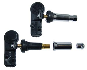

Originally Posted by Nbjeep
The 2013 stems are not metal
I thought that, too, as I said in my post above but apparently there is an available "dress up" kit.
TPMS bling.....
(also note the brass shoulder under the threads to indicate TPMS)
