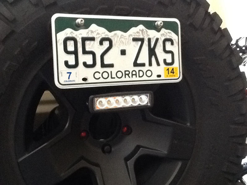

Custom bracket as I wanted it high enough to keep my lug lights.
Details on the bracket? I might want to do something like this, too.
Old Dec 31, 2014 | 05:14 AM
Jeepstin12's Avatar
Posts: 2,482
From: Denver, CO
I bent band stock aluminum. It attaches via the top stud for the spare. Basically, it takes the sauce of the spacer for the lug lights. A couple bends to get the angle & height correct, riveted an angle piece to the top. Painted with bed liner and attach. Drill holes to attach light, plate, etc. then, I wanted a clean look so I installed "lightnin' bolts". Those are the led bolts holding the plate in place. Inexpensive and are actually brighter than what the pic shows.

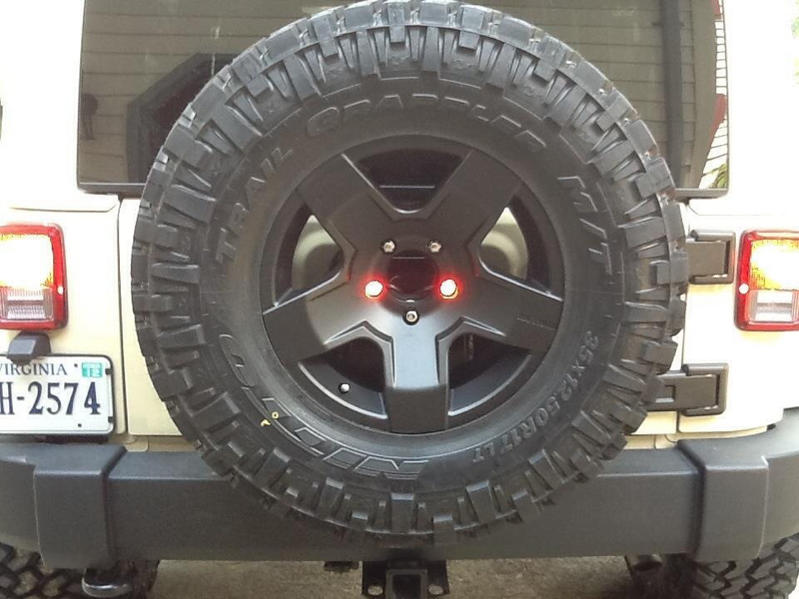

I used a light from northridge I dont even remember which but it used to be on the bracket thats on my carrier (poison spyder rock brawler with carrier). But I hated the way it was so right now I got a small piece of foam from Michael's and ziptied it on my spyderlock ring.
Best picture I have this second if you want I can get more later.
