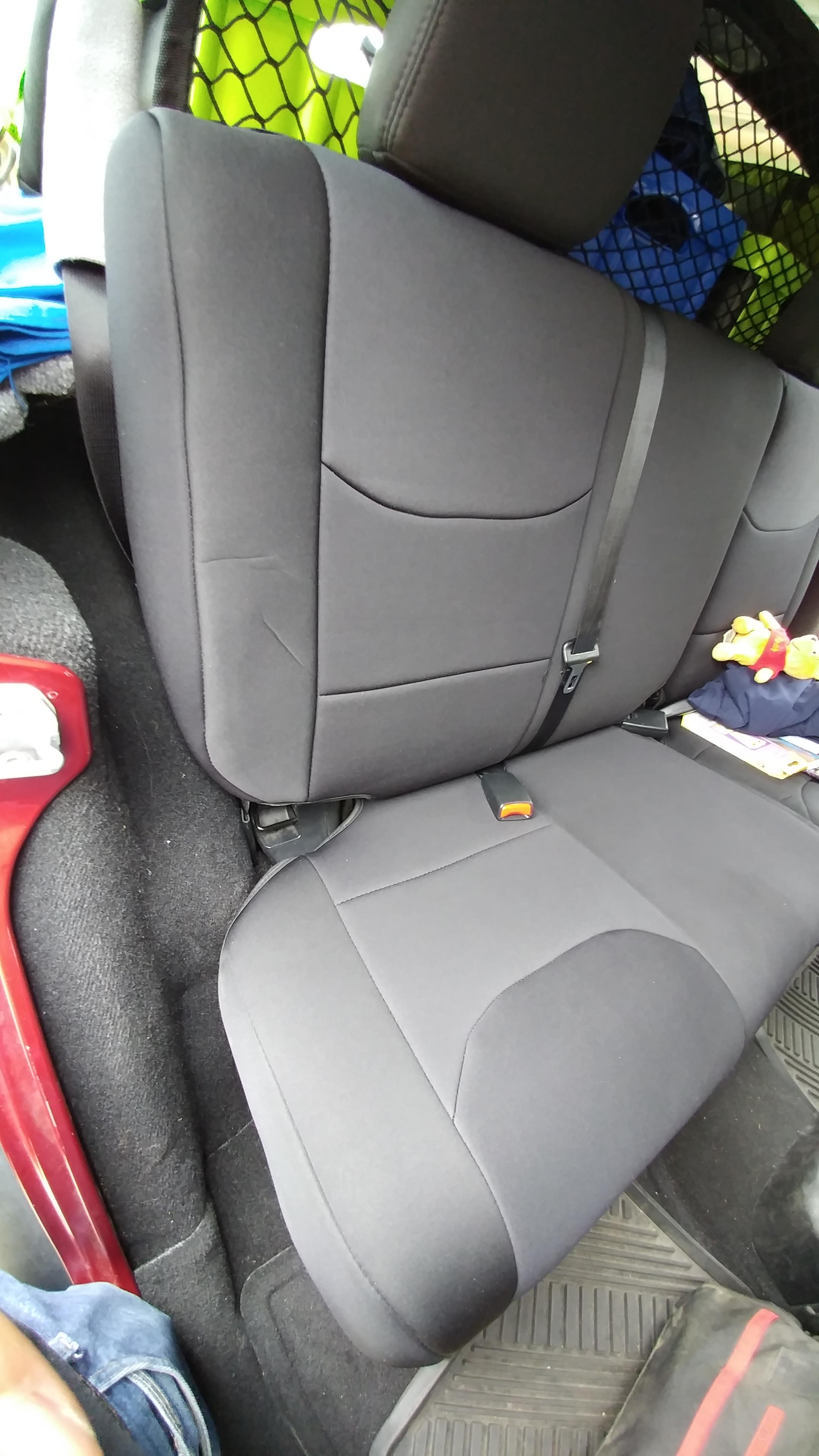

So I took a gamble and ordered the 2013+ seat covers. They fit like a glove - including the head rest.

With one exception. On 2012's (not sure about 2011's) the way to fold them is by pulling a "rip cord" on the lower outside portion of the seat. On the 2013+ seat covers it's covered as it seems that the way to fold them is by pulling on something on the top of the seat.

Y, on the '13+ there is a lever on top of the seat back. Interesting. I didn't realize the earlier models method of engaging the fold was different. Looks good.

Yeah it looks great and the annoyance of having to dig under the cover to fold the seats is survivable considering the cost of the cover
