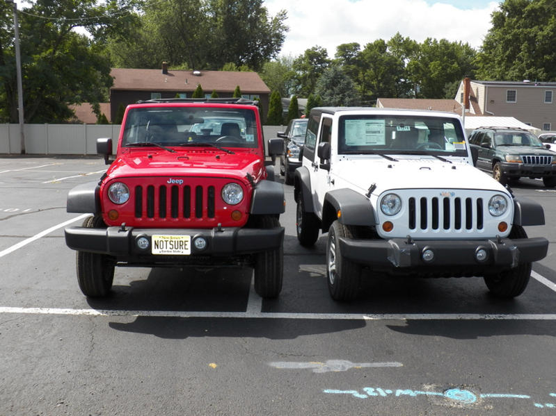

Before and after. These were from an unlimited. They are 18 front 58 rear.
Earlier in the thread I was told to use 19's , confused.

18s are what I used and it worked great so I guess 19s would work better
