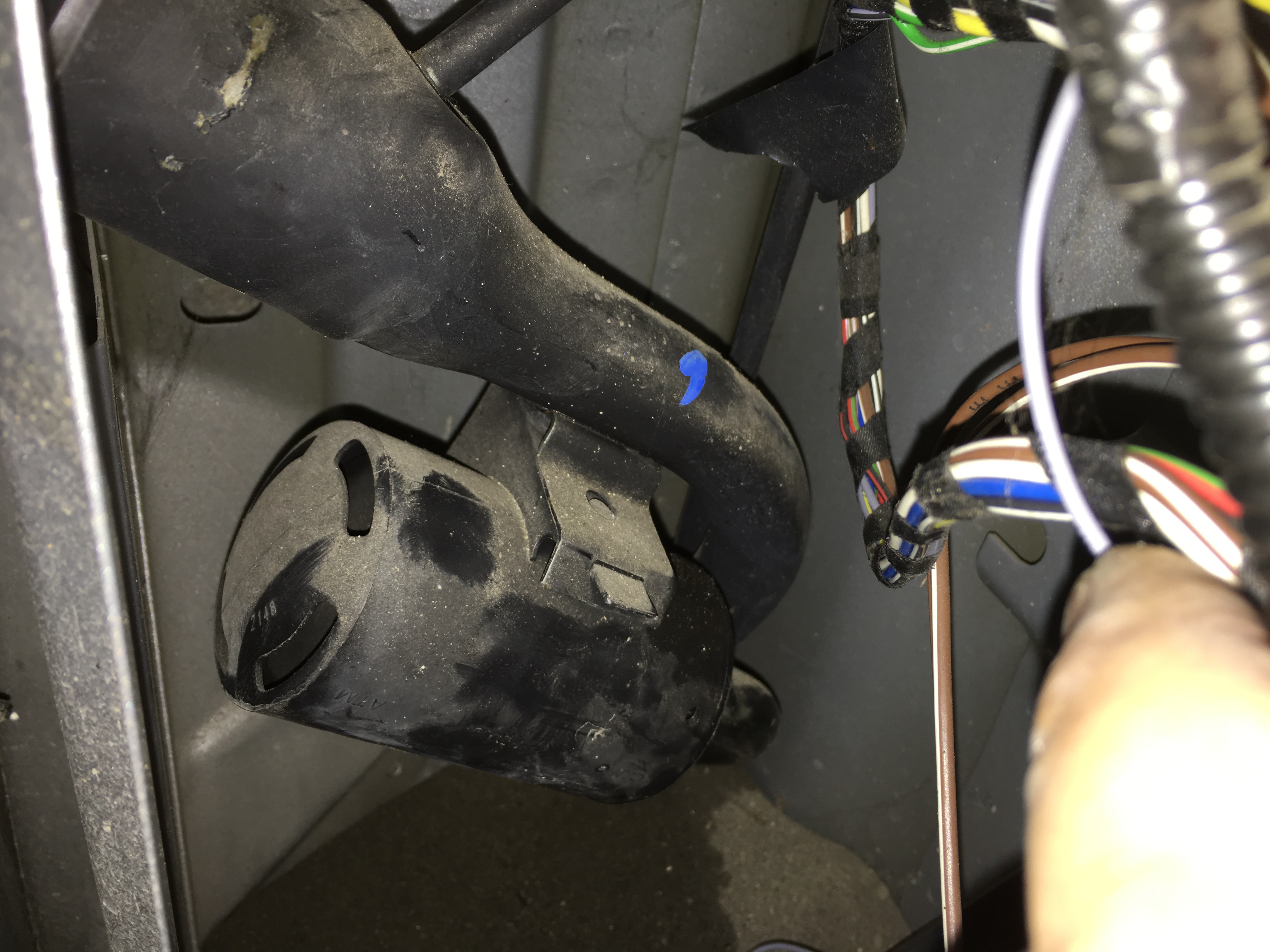

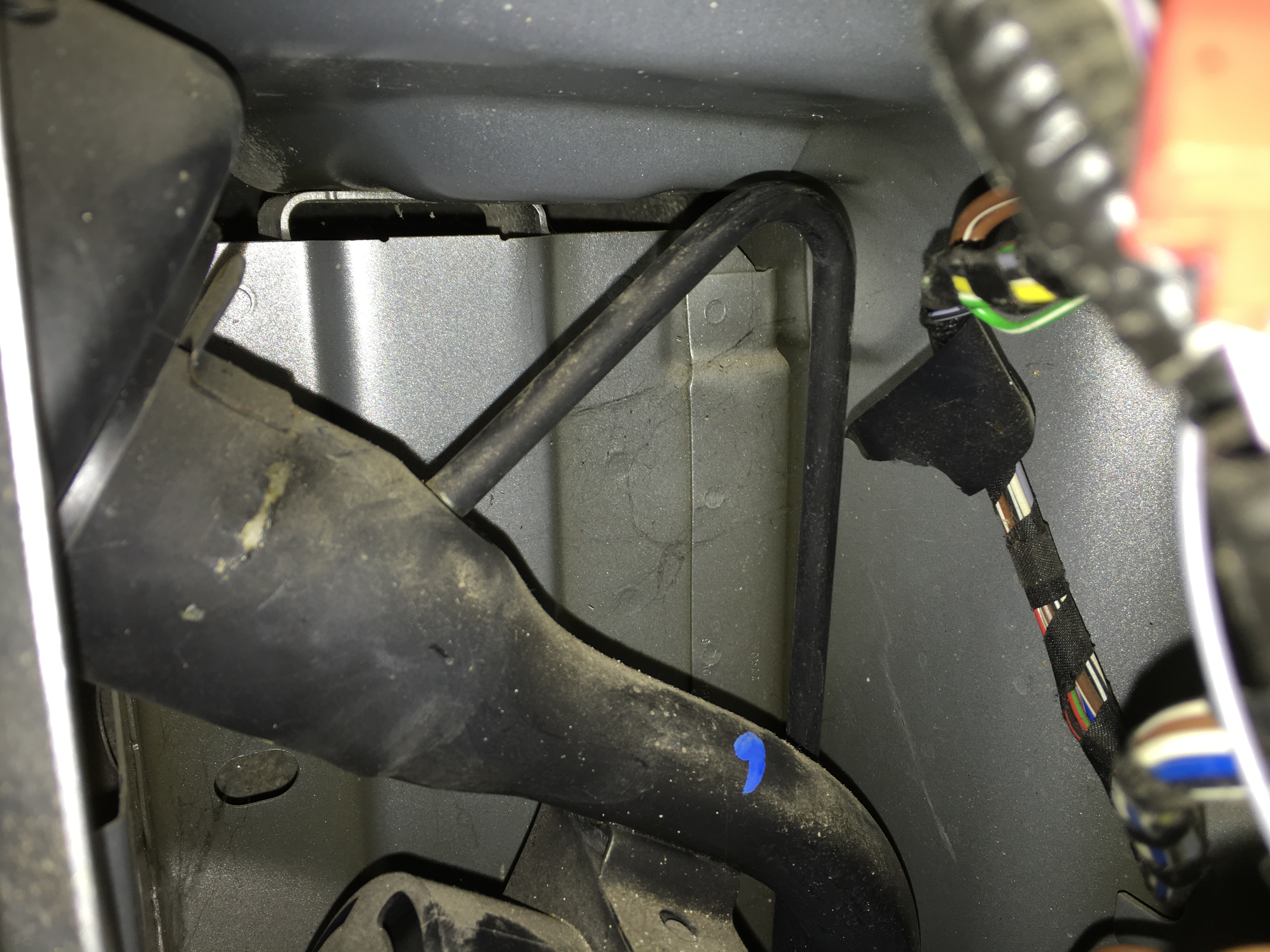

It’s long time that I have problem during refueling of diesel about my RUBICON (JK Wrangler Unlimited 4 doors 2010).
I have to spend at least 20 minutes or more to insert diesel (to have full tank) because of a continuos overflowing.
What do you think about this problem?
Does anyone know about the pieces showed in the attached pictures?
I have took them by the cavity of rear left light. Click image for larger version

I'm shure that during the first year of life, my RUBICON had not this problem.
I'm not really shure, but this problem seemed go away after a period during wich I left my RUBICON without its battery.

Old May 27, 2016 | 07:11 AM
karls10jk's Avatar
Posts: 5,642
Likes: 486
From: Knoxville
The check valve in your filler neck may have gone bad. Check part number cnnx321ac.
