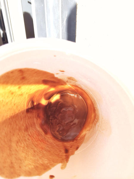

I have attached a picture of the sludge. They kept it in a big gulp cup to show me.
So they only cleaned out the overflow, and topped off the fluid.
