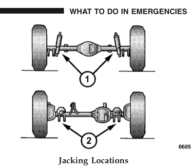

Stock height. Tried the points on frame just rear of the front passenger (flat) tire and a few points on the axle. The scissors jack was fully extended and I simply couldn't lift the jeep high enough to pull the flat tire off.
If your scissor jack doesn't raise the axle enough when used at the proper jacking locations below, something's wrong with your jack.
I'm running 35s and still use the stock jack with the AEV jack base that came with my lift.

Aristo is spot on. There is even a groove cut in the top plate of the jack to fit the lift points. This thing has plenty of travel and then some. You just have to use the correct lift points.
I must have been missing the crucial lift points I figure.
