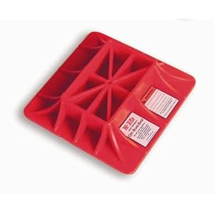

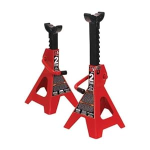

IMO, you can somewhat safely change a tire with a hi-lift + the following accesories, just seems like a lot more work that the stock scissor jack + the AEV base (or some extra wood).
1. Use the hi-lift off-road base if you're on an unstable/loose ground
2. Use the lift-mate attachment to raise the tire/axle
3. Once the axle is lifted high enough, use a jack stand to support it; remove the hi-lift
4. Replace the tire
5. Use the lift-mate to raise the axle; remove the jack stand

Yes, that would be a safe way to change a tire with a Hi-Lift jack. Impractical, maybe - at least for me. I don't carry jack stands, especially when wheeling. Just one more item to secure and extra weight I just don't need.
What exactly is wrong with the stock scissor jack for changing a flat? Lift makes absolutely no difference since you jack the axle, not the body. It works just fine on my 35's. A small 2x6 makes for a stable platform. When I put the 37's on I'll just carry one more short piece of 2x6.
