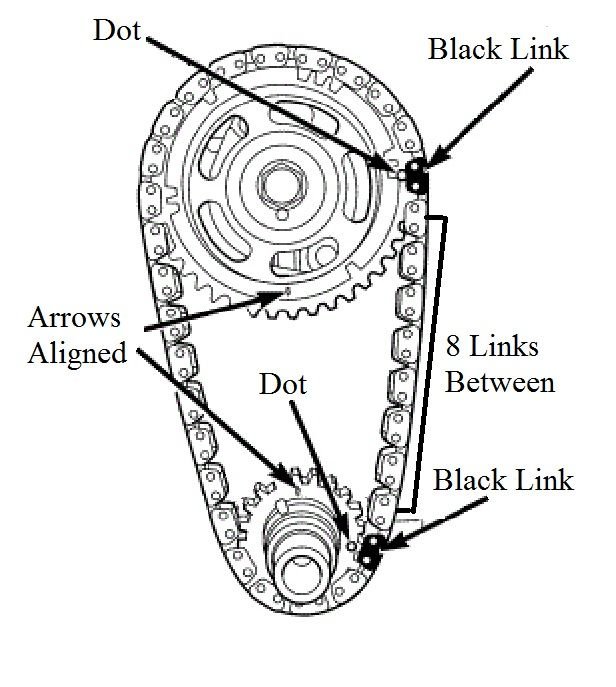

Hello, I am curious if anyone can clarify something for me. I am going to rebuild a 3.8, I heard for this motor, to set timing you have to get the #2 piston to TDC instead of the #1. Is that true? Please let me know, thanks for your time.

Follow this diagram for the 3.8L engine and you don't even have to know which cylinder to choose.

I know about that diagram, that is to set TDC. So in a built motor, that should place the #1 cylinder at TDC. I have a bare motor right now. So when I put on the timing components I have to make sure the correct cylinder is at TDC. I can’t find anything in the s device manual I have. My gut says it’s the #1 like every other motor. But wanted to verify so I don’t bend a rod or anything like that

When that arrow on the crank is pointing up, #1 will always be at the top. Follow the diagram and it will automatically be correct.
ok that makes it easy. Let’s see how this goes. Thanks for the info
