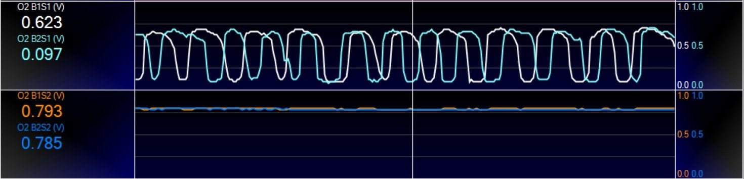

The way the pcm detects low cat efficiency is comparing the lean/rich oscillating of the upstream sensor (normal is about 0.1 to 0.7) to the downstream sensor (normal is ~0.75 and fairly steady).
Graph it at hot idle, and steady highway cruise, post a pic if you can. The classic cat low efficiency fail is when the downstream sensors are oscillating similar to the upstream. If the cat was acting like a straight through pipe with no catalytic action, the upstream and downstream would look the same. Actual A/F ratio problems will likely set other codes. Suggest concentrating on the cause of the DTC's. The speed bleed-off is probably related, but a DTC is simpler to nail down.

O2 sensor graph (normal, hot idle)
Here's a O2 sensor graph at idle of a normal engine with about 140K miles on the engine/cats and no DTC's.
Top is the upstream sensors (oscillating rich/lean). The lower chart is the downstream (steady and almost the same).
