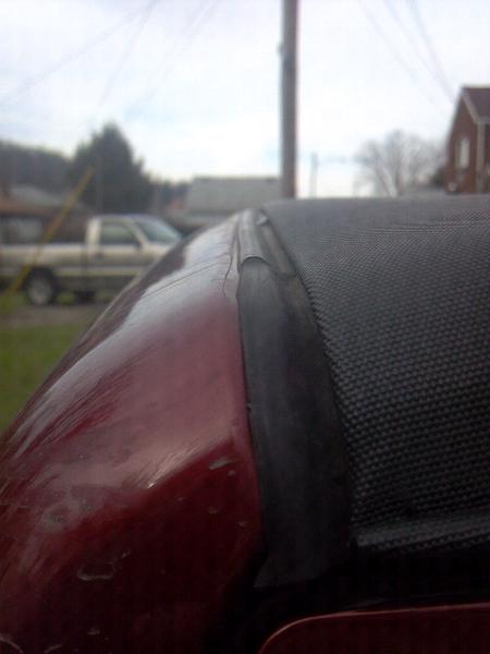

Here's mine. 07 hope this help out

Okay so I got the metal header now and it's was hard to latch the top and it seats do much better, but I still have the leaks in the same spot. Any more help guys?
