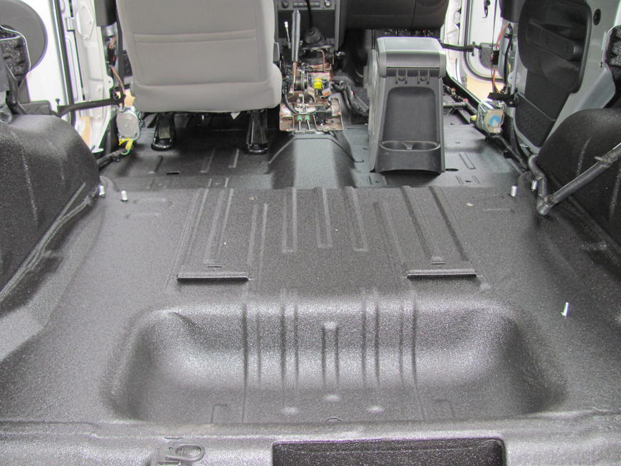

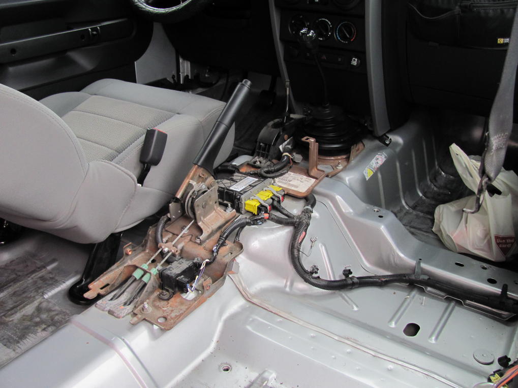

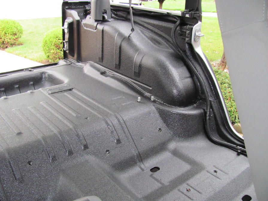

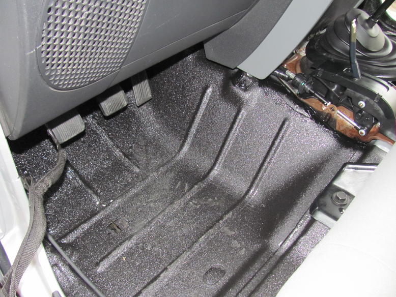

take it from me.....chisel that damn shit out....if your carpet has ever been wet ( rhetorical question i know ) then rust is occuring under that crap. I chiselled/wire wheeled down to bare metal before having my tub Line-x'd. The drivers footwell was the most saturated and came off really easy....the rears were a bitch but the clean look and peace of mind knowing my tub is not rusting was worth the sweat!

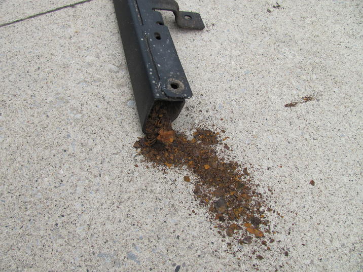

oh ya..if you have rubi-rails check out what happens to the insides after two years
