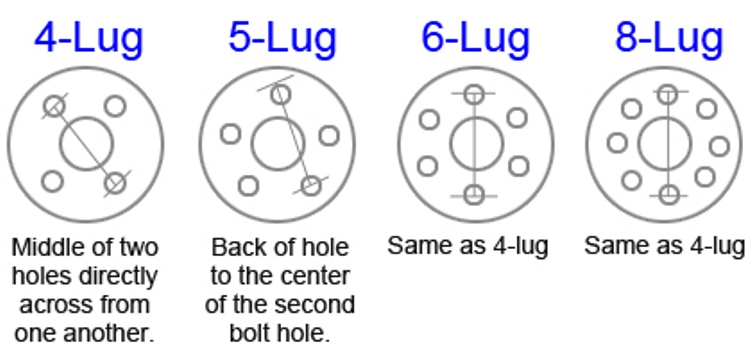

Originally Posted by Roughneck
Measure the bolt pattern on the spacers. Maybe they were marked wrong.
Here's a chart on how to.
