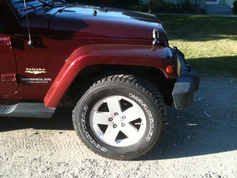

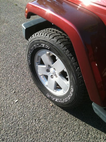

I recently mounted 285/65R18 Goodyear wrangler silent armours on a 2007 JKU Sahara. Only rubs at full steering deflection. I Was told a leveling kit of approx. 1" would resolve that issue.
I don't think a leveling kit would fix rubbing while turning the steering wheel all the way. You would need 1.5" wheel spacers for that
