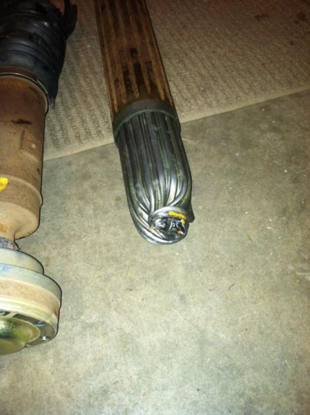

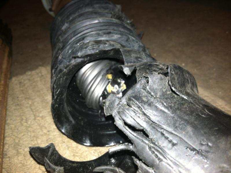

ha yeah, you should be good with a torn boot, just don't do this!!!
ID:	278411   Click image for larger version
ID:	278412   Click image for larger version
Yeah, that is probably not good
Damn !!
