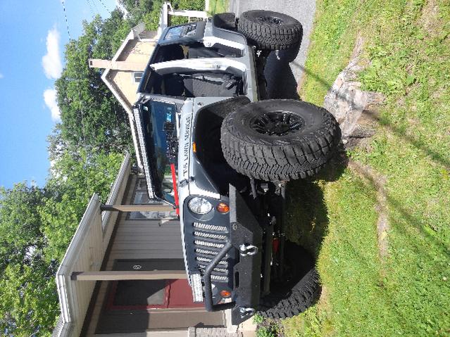

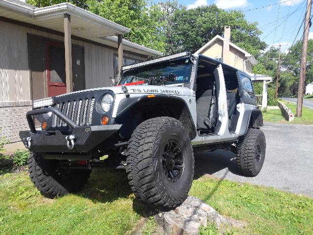

I was running 35's and no lift. Just have to cut the fenders. If the 33's are 12.50 then u may have slight rubbing at full lock and will definitely rub if you flex too much. Im heading to bantam next week also. Maybe see u there. Keep an eye out for this jeep

I'll definitely keep my eyes open for you! She's beautiful! I could only dream of making my JK that beautiful! Mine is nothing special. Just a red rock crystal 2010 2 door sport. Nothing really outstanding except for the Penn State tire cover. The tires I'm looking at are 285's which is 11.2 inches wide, so I think I'm going to go for it! If it doesn't work out, I'll post them back on Craigslist!
