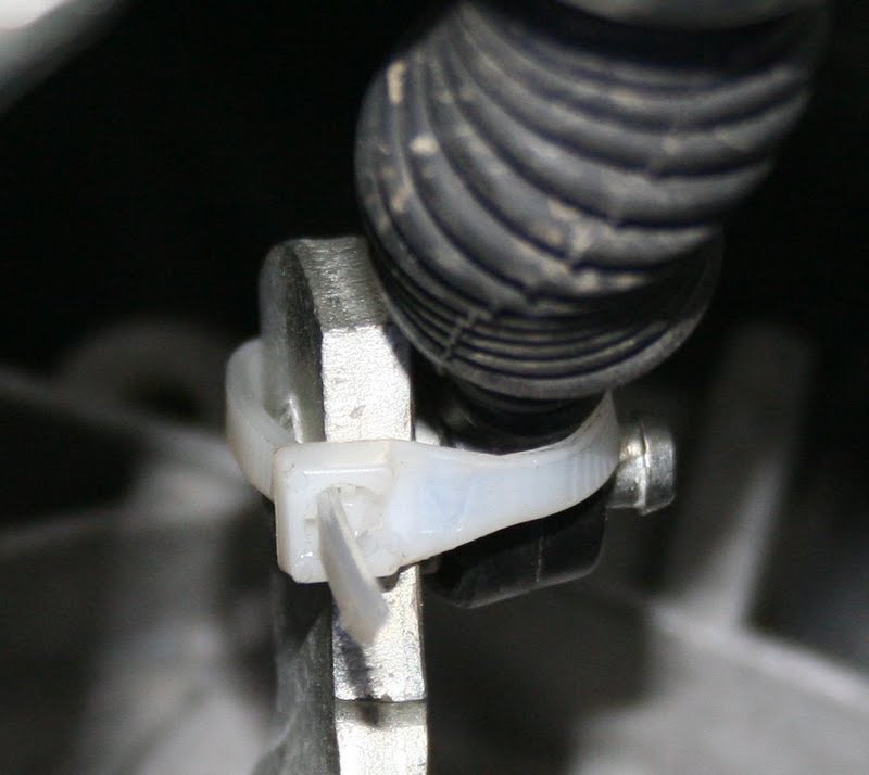

It's common. The plastic retainer for the cable breaks where it connects to the t-case lever. A few have broken at the lever under the console.
New retainer is about 25 cents from the dealer. 68064273AA is the little part you need for the end at the t-case.
In an emergency you can get underneath and move the lever to 2hi by hand.
You can also reattach the cable and hold it on with a zip-tie.
Look here https://www.jk-forum.com/forums/stock-jk-tech-12/4-wheel-drive-cable-breaks-100876/
And here https://www.jk-forum.com/forums/stock-jk-tech-12/stuck-4h-%7E-ugh-100401/
Here is a pic I found on the internet showing how to apply the zip-tie.

Thanks. Is there any way to prevent this from happening again?
First thing is be easy on the lever. If it doesn't go easy, things are not lined up and more force won't help. It will just break the retainer.
I was just looking for a thread that showed how a guy made a metal retainer that threads on with a bolt. His will not break again. I can't find it right now, but if you search, you'll see it.

Thanks ronjenx! Thanks to your advice I was able to get my JK rolling in 2H. I'll be taking it to the stealership on Monday and immediately using the ziptie mod! That's the reason I keep coming back to this site.
