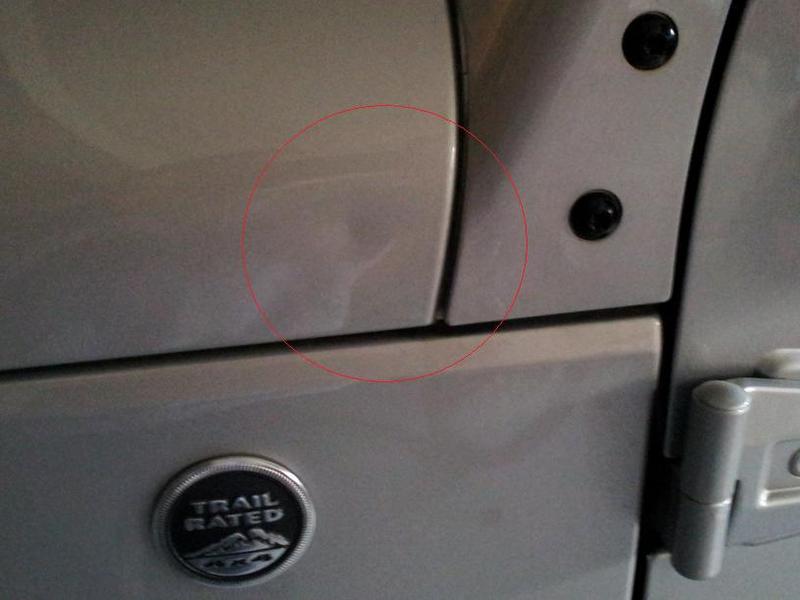

Piece of advice when removing front doors. Be careful not to let them open all the way. If they do u can easily dent ur jeep with the mirrors.
...and will look like this.
Should come factory with those haha i got them on both sides. One by me other my gf. Ha
