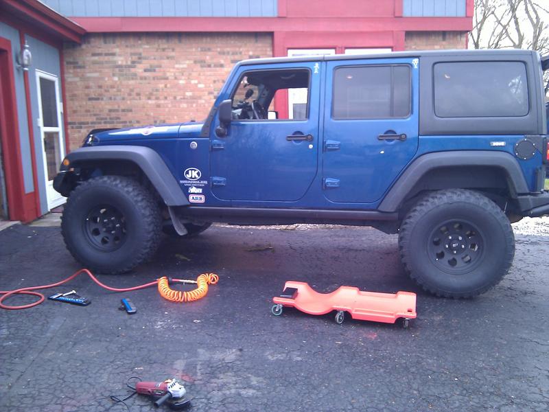

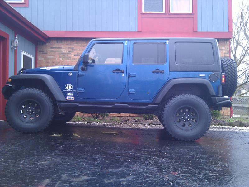

Hell, I take mine steps off to go on the trail, I then put my Rubi Rails that I've welded shut and plumbed as air tanks on...
Then the reverse once I'm done on the trail... Those rails usually stay on for maybe a few days once every couple of months...
Keeps the wife happy and the rails are used for what they are ment for... Well sort of...
Attachment 400822
Attachment 400823
So...your rock rails act as an air tank any more info on this?
