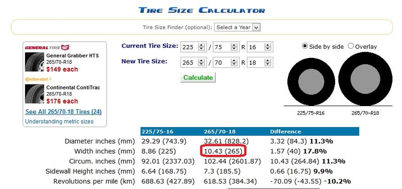

Plug the numbers into one of the conversion tools online. Looks like the tires you want are only .5" taller and .4" wider than the ones that come on stock 17" and 18" rims.
You don't need spacers or less backspace/offset on the new rims, but since you are getting new rims, why wouldn't you go ahead move the tires out? Or are they stock 18" rims?

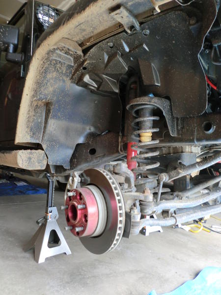

You may not need wheel spacers. I have a Sahara that had 18" OEM wheels and was running 11.5" wide tires and I needed 1" spacers or I would rub.

The tires you're looking at are just under 10.5" wide (1" narrower than I was running) so it would seem you might need not them with the tire size you're considering.
