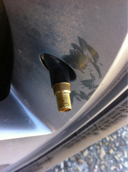

Here is a pic of the valve stem.
Does this tell you anything?

That is a TPMS rubber valve stem. That extra brass shoulder is the tip off.
You tried upping the pressure on all 5, did that "cure" the warning? What pressure did you go up to?
Can't say why it took so long to register, but maybe it registers each individually one at a time and took that long to read all 5.

If you're at 37 and have driven for more than 20 min. and you still get the light, you might have a faulty sensor. That will trigger a light. Spares have sensors but they won't set the light off unless they have been mounted and rolling. They then synch. to the computer and operate normally.
