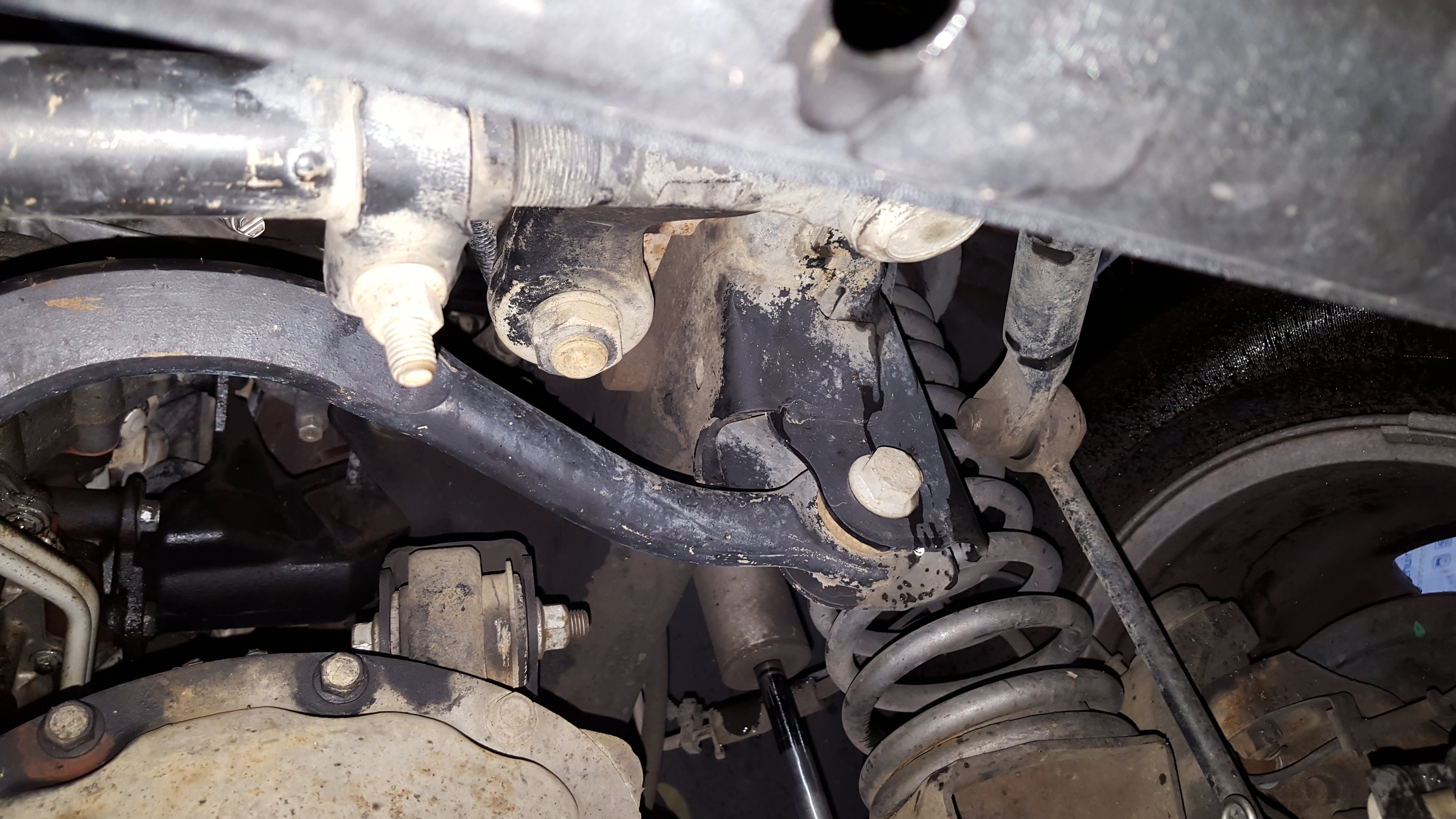

So post a picture of the front axle from hub to hub. That'll tell us.

I took a picture of both ends then read your post again, if this is not enough I'll take another pic. Here they are.Click image for larger version

I took a picture of both ends then read your post again, if this is not enough I'll take another pic. Here they are.Attachment 628779Attachment 628780 Hopefully they show up.
Yeah, it looks like you have a raised track bar bracket on the axle side.
