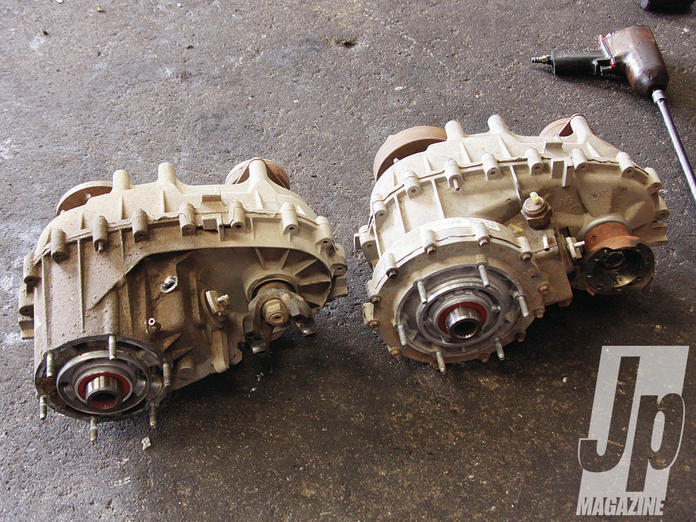

Too funny... I was reading the same JP article in my "office" this morning...then decided to crawl under my '07 Rubicon in the garage and was concerned as well as I saw NV241J on the ID tag of the t-case instead of NV241OR. Then I spotted the Ratio and it's labeled 4-1. I think the article is just slightly off indicating that the stamp on the ID tag would read NV241OR as it reads NV241J instead. I was getting paranoid that over the years some mechanic swapped out my Rubi T-Case !!!
My t-case matches the on pictured in the right anyway which according to the article is the OR (or Rock-Track) version for the Rubicon.

Originally Posted by JKJA10
What T-case comes with the sport 2010.
I believe it's the one pictured on the left above. NV241. 2.72:1 low range ratio.
