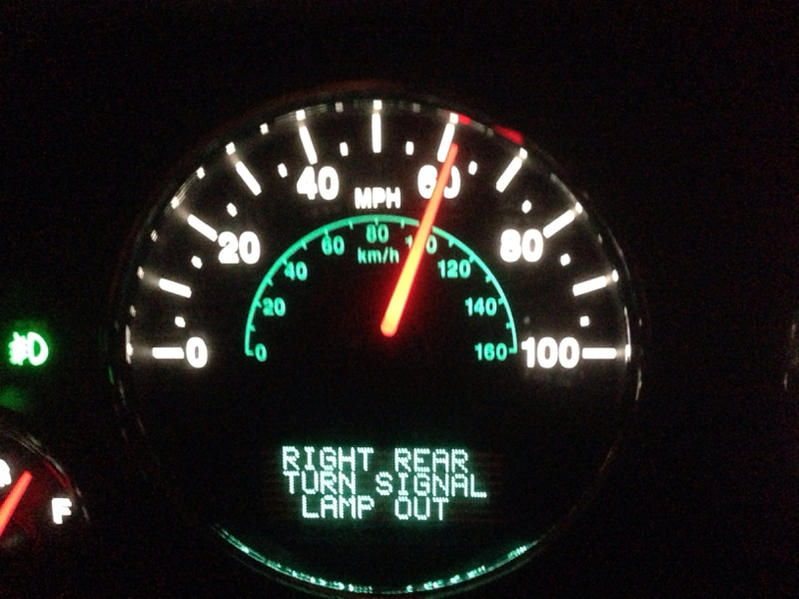

Got this warning this morning. Haven't had a new vehicle since 2001 so maybe this is common. I'm glad jeep put it there because it saved me a ticket!

It's my rear signal not my
Front. The brake lights still working but the turn signal doesn't work. Also I have a 2012 so I'm sure this is for 12-13-14 models
Something isn't right here.
The turn signal and the brake light are the same filament in the bulb. They also share the same wire all the way from the TIPM to the light socket.
A problem in the TIPM is more likely.

Yeah, need clarification from the OP if "brake light" means the rear marker filament when the running lights are on, or if it's the brighter, stop lamp/signal filament, as those operate off the same filament.

When I checked it this morning the running lights were on but the turn signal was not working. I was alone so I couldn't check the brake light function. I got out of work and started it. The warning light was still on and the turn signal was still not lighting up. I took the light housing off and wiggled some wires. Started it up and it was back to normal. I have no idea what is going on now.
