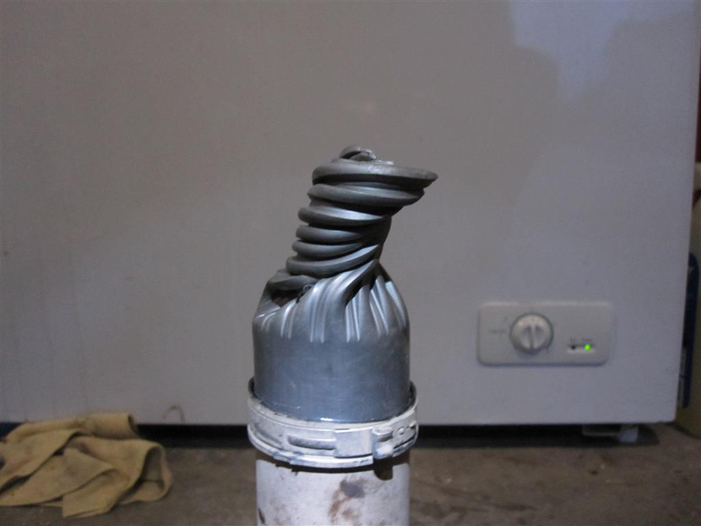

If I twisted my front OEM drive shaft on an 07 two door rubicon what other things have I caused damage to?

What you got under the hood; a supercharged Hemi? If you've managed to do that to the driveshaft I'd be checking your diff centres and drive axles and front U-joints very carefully.
Just as a matter of interest, what exactly were you doing when this occured?

I was pulling an activist groups' mud stuck rv that was abnormally large.
No lift and my Rubi is stock. Tow strap didn't break. In 4 wheel low.
I removed the shaft waiting for delivery of new one. Everything seems to be working now that the shaft is removed.

That has happened to quite a few stocker ds's on here, would prolly be more if peeps didn't change there's out so quickly after doing lifts. Stock ds's are crap. Only thing I'd be worried about checking is your axle u-joints, make sure c-clips are still on and the caps look ok.

Been there done that! Those stock drive shafts are utter junk. Mopar screwed up big time on the design on those.

Actually, you're probably lucky that the DS did fail under the extraordinary strain and acted as the weak link in the drivetrain, otherwise you could have grenaded the diff or snapped an axel shaft. Driveshafts are relatively cheap and quick to replace, entire D44 setups are not.
