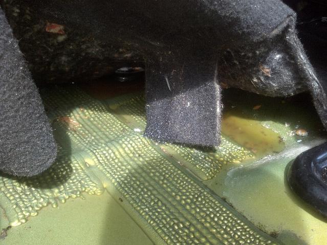

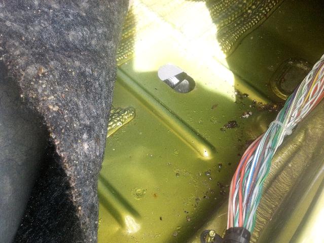

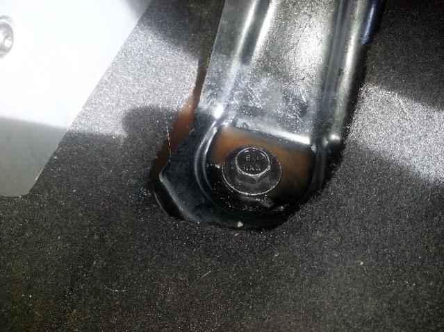

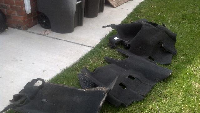

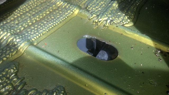

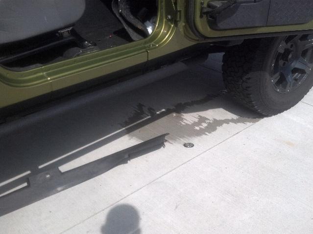

Ok.. i went to the carwash to vacuum the jeep. Lifted the front passenger floor mat to find the carpet SOAKED. It's not wet up by the firewall, just the floor. I went thru the drive in carwash and noticed when i came out there was water leaking in the front top door seal and running down inside at the bottom. But there is a ton of water on the floor! I pulled up the carpet and the trim panels and there is so much water i had to pull the drain plug.
It's not coolant, has no smell no color. I'm wondering if it is simply the door seal or i have a bigger problem.

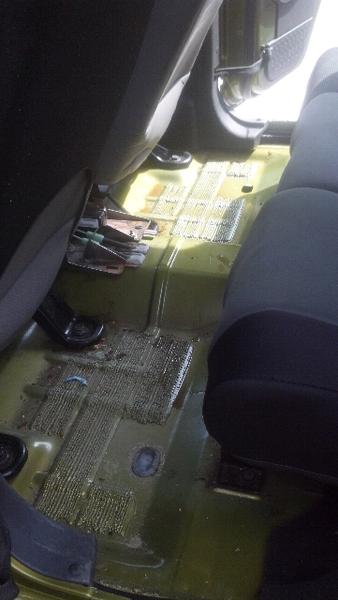

It's even went behind the front seat in front of the back seat! Dafuq!?
This last pic looks a bit like coolant, but i think it is just funky water. Has no odor other than what you might expect funky water to smell like. Well.. i've always wanted to pull the carpet and bedline it... so.....

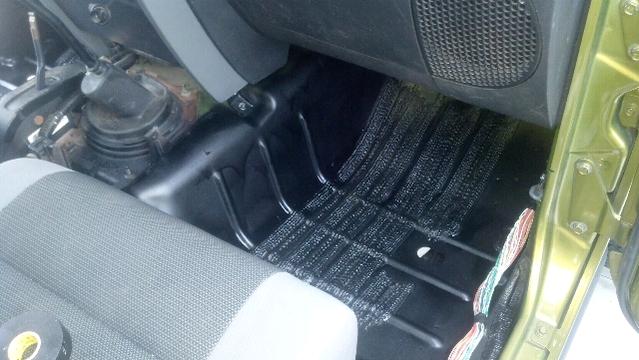

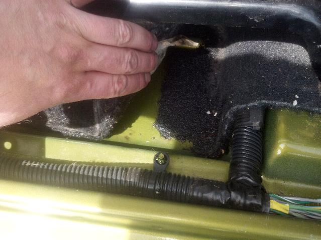

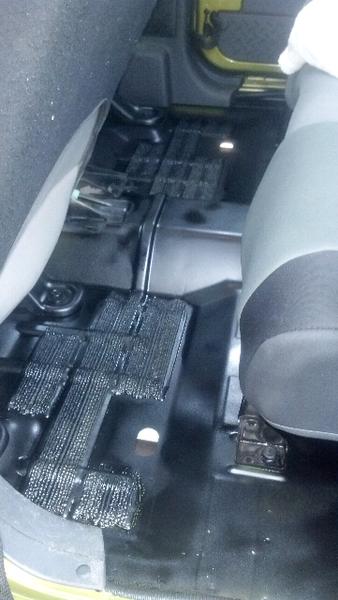

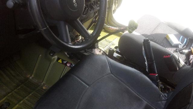

Yes i think i have the same problem; just the motivation i needed to yank the carpet and start bedlining! I did 2 light coats today before it started storming. Several more to come as i am on vacation this week.
