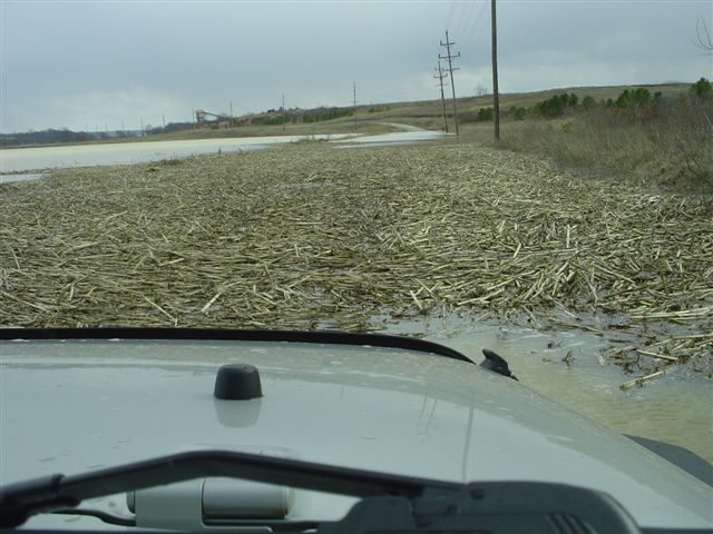

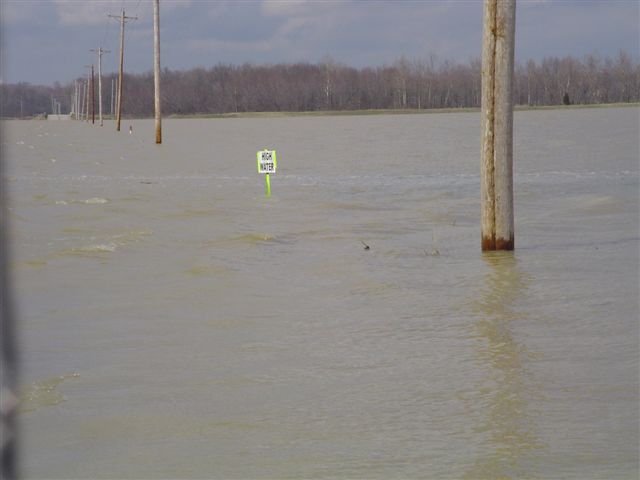

I went out and played in the back water this weekend with my folks and we went through record breaking water at least for my jeep and I was wondering if i went through water that was no deeper than my door if i was ok? Meaning that my diffs, tranny, transfer case, etc. were probably good. If not would I be able to notice? I also did some shifting but the water was probably 6 inches from the door sil. I looked under it while stopped and the water was probably just barely touching the trans. I loved playing in the water just get a little scared afterwords because of the fear that I may have pulled in water. I would appreciate any water fording success stories. I have a 07 stock rubi. no frils.
Ill try and attach picts.
