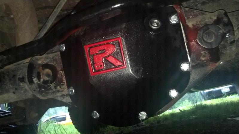

Power steering pump, diff cover and splicer for my rear drive shaft.
