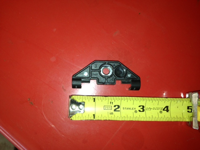

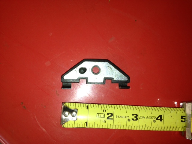

('09 JKU) Found in cargo area laying atop the left wheel well hump. Perhaps seat belt related?Click image for larger version

Looks like the piece to tighten your hardtop down
That's exactly what it is. The rear-most one slides out of the channel sometimes. You can just find the opening in the channel and slide it back in.
X2. Should go under rails in tub. Its a captured nut

Yes, looks like a hardtop bracket. They line up with these holes... (on a '12 JKU anyway)

Thanks all!!! Case closed
