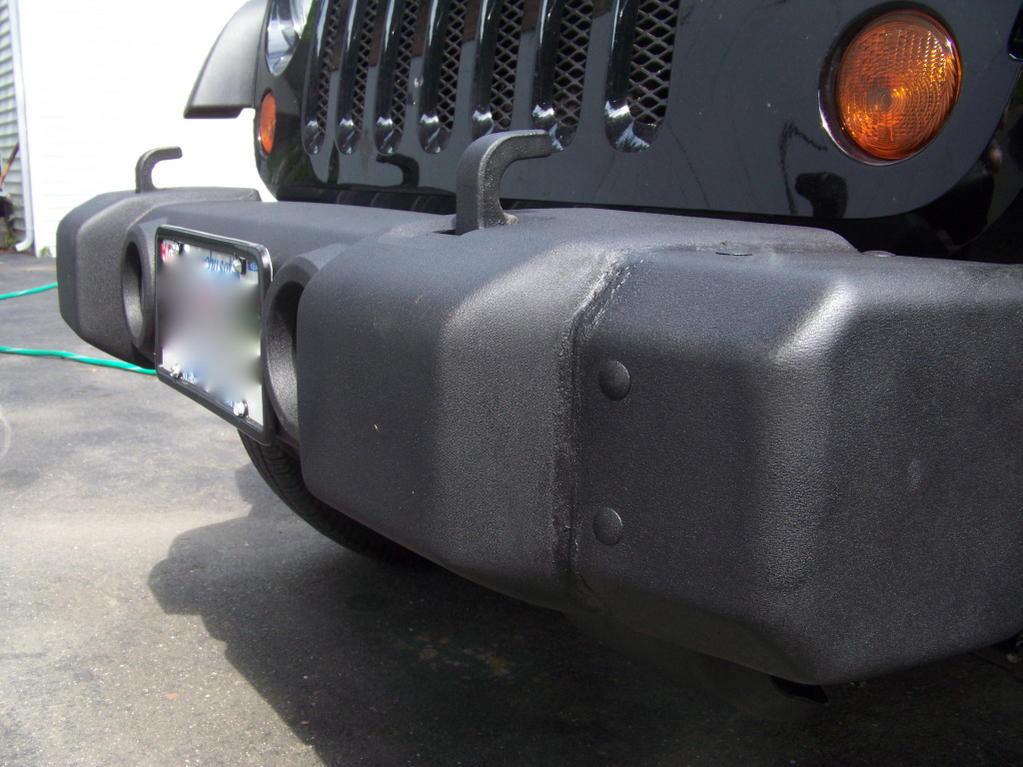

Pick up the Rough Country bumper cap kit - called them directly and got a good deal. It cleans up the look a lot and is super easy. I got fancy and wanted to blend the two pieces better so I siliconed the edges and then bedlined the whole bumper.
That looks pretty nice.
I might just do this, now.
What kind of silicone did you use? Roofing sealant?
As for the bedlining, did you use the the spray-on stuff from the local autoparts store?
Thanks
Thanks
Tube of the standard indoor/outdoor stuff for windows and and door trim. Got black and it actually matched the bumper fairly good once it dried. The bedliner was the Rustoleum spray on you can get anywhere. Scuffed everything up with some medium sand paper and went to town. I could have taken a bit more time to blend and smooth the silicone out between the pieces but I think it works fine for what it is. Well worth the $5 for that and the $6 or so for the bedliner.

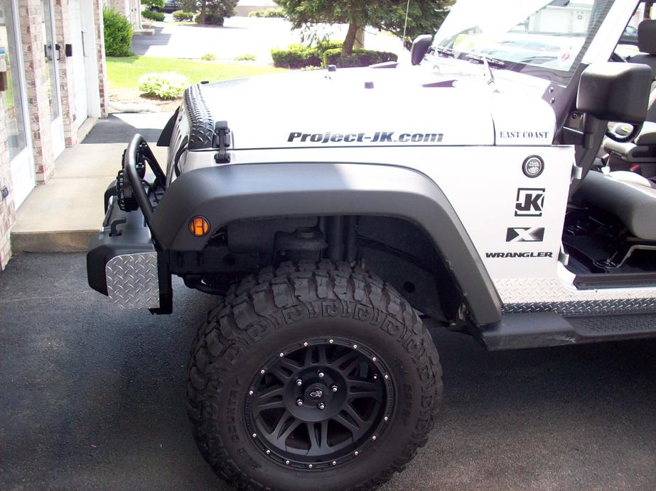

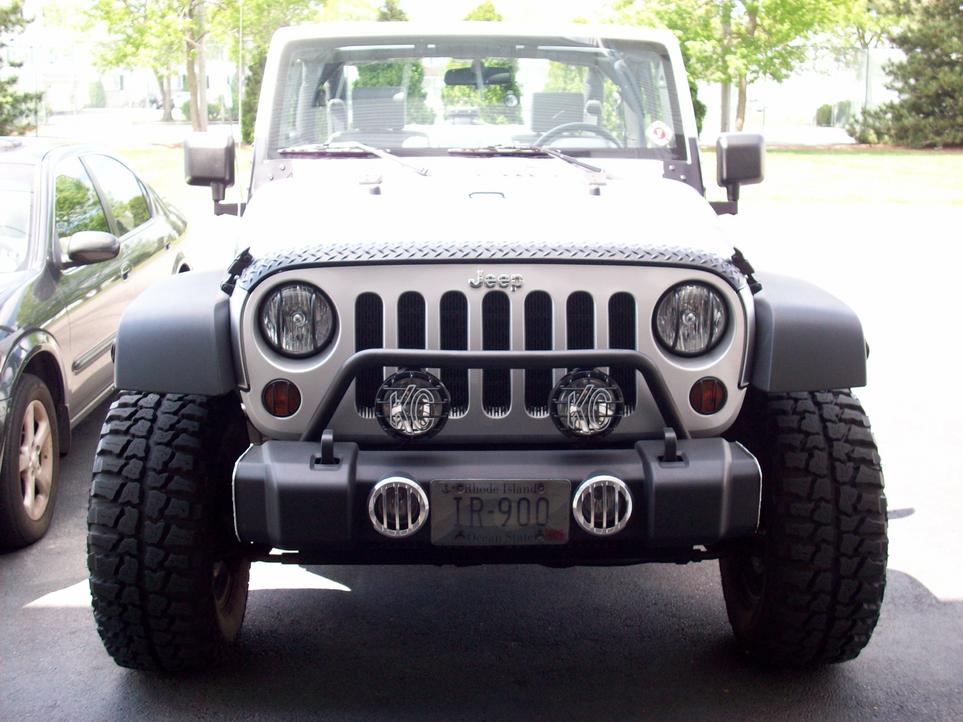

Had some to spare so I cut it to fit the ends.
