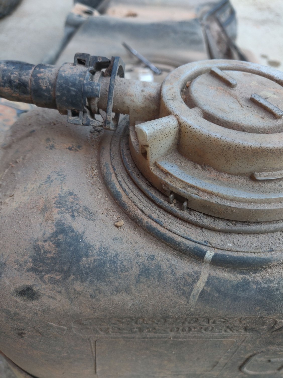

Default F#!@-ing plastic piece snapped off! See pics please help asap
This line comes down with the gas filler tube...connects on top of fuel tank...it snapped off. I don't know what it is. See pics and please help asap! Must fix tonight if parts are on hand at local auto parts store a.
Where snapped from line running along fuel fill hose.
Where snapped on tank
Top of tank

That part is almost certainly going to take a dealer parts department or a wrecking yard to find. If I'm reading the pic correctly, it's a filler vent and it broke where the quick-connect attaches. The dealer will have a parts diagram, should be easy to identify what parts are available separately and as an assembly. I'd search the on-line dealers for a parts diagram and prices tonight...
