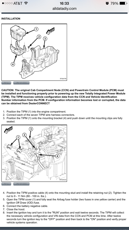

Dealership just called me, $627:52 inc tax. She's fixed and ready for pick up. Thanks for the help guys.
Old Jun 24, 2015 | 12:34 PM
  #34
bevan7170's Avatar
Joined: Nov 2013
Posts: 494
From: 16648, PA
For those that mentioned self installing the modules. Here is a how to...
