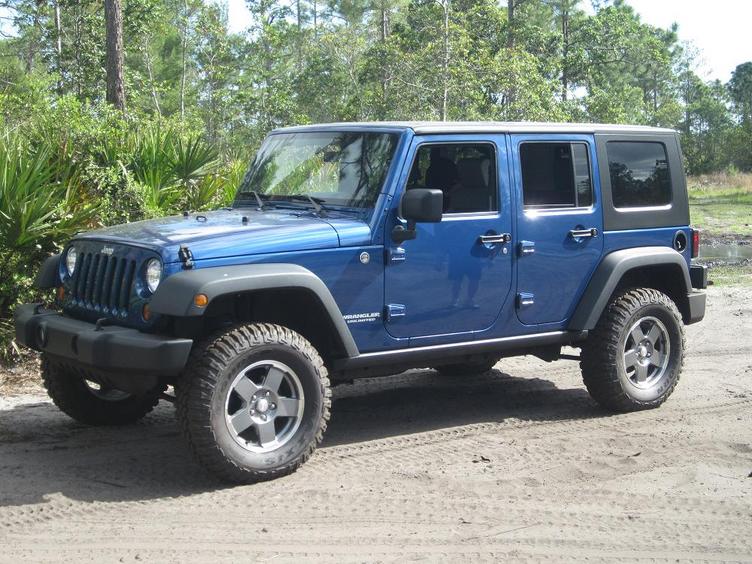

You will love the Bighorns, they do make a little noise, not bad. Here's mine on stock size rims, (with spacers though), and a 2.5 lift. I did not have to trim rock sliders or air dam.

Are they the 285/70/R17 Maxxis Bighorns
Old Jul 6, 2012 | 01:41 PM
jonb1032's Avatar
Posts: 185
From: East Coast, Florida
Yes, I did forget to mention that. 285/70/17, a little taller than stock, look great. My jeep is my daily driver so I was worried about the aggressive tread, but really not a big deal. A little hum at highway speed. I have stock 3.73 gears and auto so I was worried about taller tires. (i.e. 35") these seem to suit my needs perfectly. Enjoy
