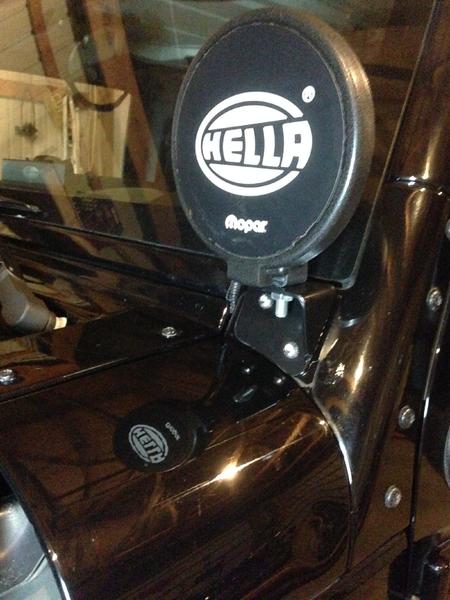

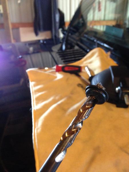

The upper left bolt was spinning free so I drilled through the head.

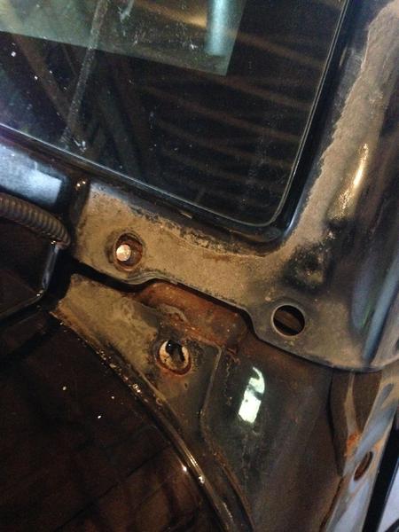

Windshield support bracket removed. As you can see, there is not a lot of room to access the backside of the fastener.

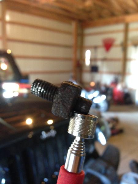

I was able to pull the remaining bolt and square nut from the backside.
The nut was severely rusted to the bolt. I had to put it in a vice and use considerable force to free the nut. I don't think it would have been possible to wedge the bracket and remove the bolt without drilling. The square nut was held in place on the backside by three tabs. The tabs had been bent out of position, however I was able to pry the tabs back in to position and re-insert the nut. It was harder than it sounds due to the limited amount of space. Inserting the nut alone was like playing a cruel version of Operation.
