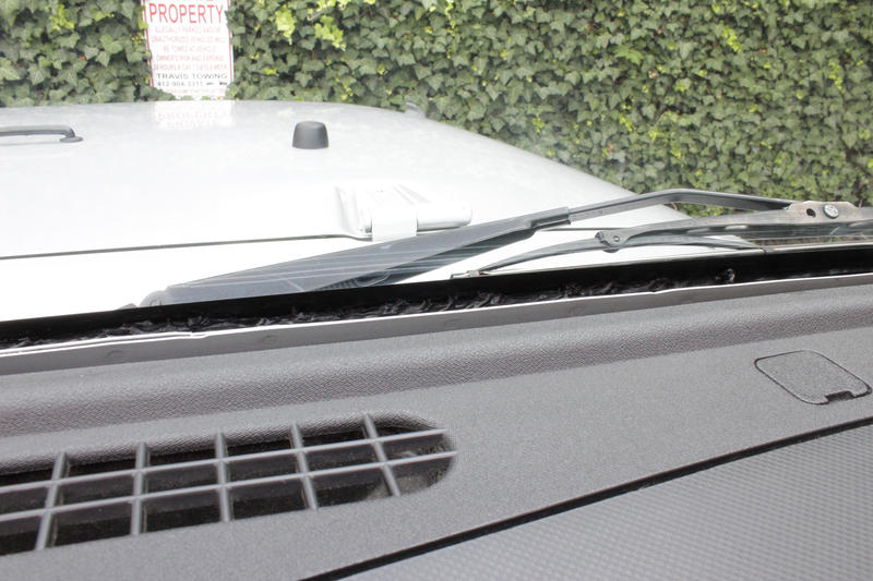

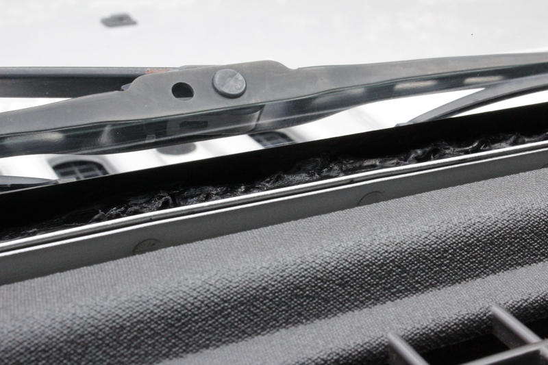

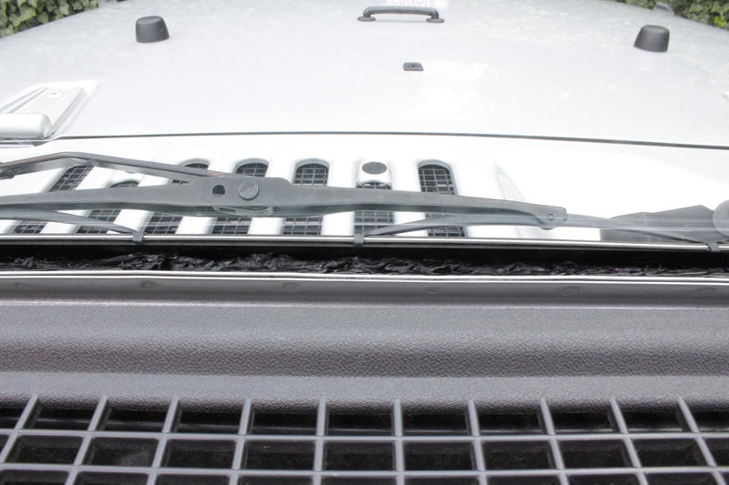

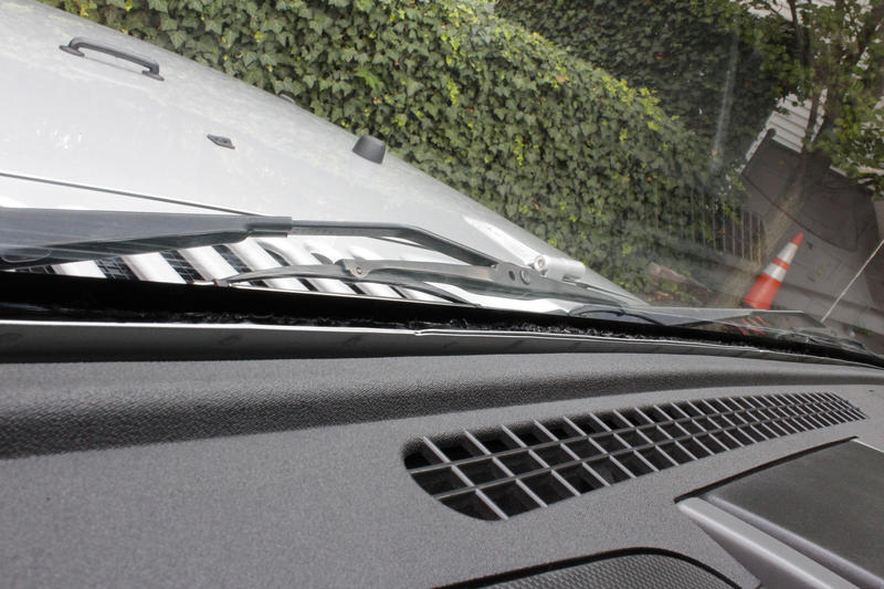

Took some more pics with my good camera to show what it looks like.

Another option.. maybe you can buy some house door weather stripping that's the right width and lay it in that channel on top of the goop. Just a thought.

While normally I'd be all about finding an easy solution like that, I'm going to take these guys to task on it.
My Jeep is at the dealer right now. I showed it to the foreman in the shop - even he commented that it looked like sh*t. The one service writer says that Safelite does their windshield installs and he said they haven't had any issues -- but they use a different Safelite shop than the one I used.
I looked at the rubber channel piece at the dealership today for the 2011+ models. I'm 99% sure it will fit on mine--it is a flexible piece with what I believe is just an adhesive backing that sticks to the underside of the dash. Only problem is, it won't extend far enough to cover the goop - it will just cover the opening between the dash and the sheet metal frame of the windshield. The goop will still be visible.
Called the manager at the Safelite shop. He didn't sound too happy to hear from me. I was nice and complimented his tech on the install -- from the outside. He cut corners, I know he had to. It's obvious he didn't remove all of the epoxy from the first install. He told me to bring it by and they could take a look at it. At this point, I'm not letting them touch it again. I'll probably be going to my body shop (which is one of the most expensive shops in Pittsburgh) to get a full quote on redoing the entire windshield frame and installing new glass -- and then Safelite can front the bill.
