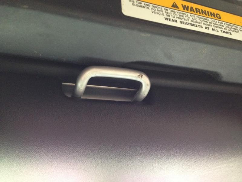

The position of the footman loop above the windshield also changed. You can either just remove it when using the soft top or grind the soft top header plastic to clear it. Otherwise you will get wind noise and possibly a leak as it keeps the center from seating fully. Also make sure you get the roll bar brackets and attachment bolts which are often overlooked.
