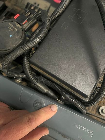

I had one of the ground studs on the body in the engine bay break off during a repair (similar to the location you have circled above). Is it okay to use a self tapping screw and make a new ground next to the broken stud, and if so, is there a specific combo of washers that I should use to build up the ground stack? (First electrical repair I've had to do; conquered the spider gears thanks to @karls10jk and @resharp001 a few years back...hoping the forum can help here as well. Pic attached for reference....
location of this ground?

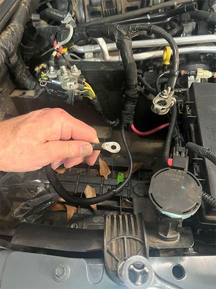

Would connecting this wire to the negative battery terminal kill my battery?

My 2010 JK Rubi with 150,000 miles on it has gone through four starters within a month. They'll start when it's cold but once the engine warms up they won't restart. All the electrical connections have been checked except for all the grounds. Not sure if I can read G101 and G104? When I do check the other grounds the continuity shows 12.7 V. (I haven't checked them when it was started since that's a problem.) If I'm correct, ground off of G101 goes to the firewall. I did clip my meter there and it read 12.7 V also. Should I try to reroute that ground since I can't reach it? Or is it good.This is very confusing and frustrating! All suggestions welcomed.

What could happen if I did that? Should I disconnect the fautly ground to the firewall? At this point, I haven't added the engine ground from the negative battery terminal to one of the alternator mounting brackets.

The ground will be from the negative battery terminal to a bolt of the bracket that supports the alternator. I will use a standard 4 gauge battery cable. Would this be adequate to avoid any overload?
