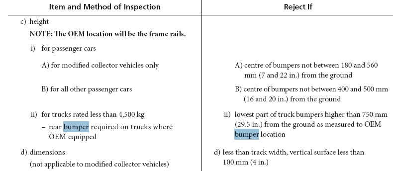

The new regs.
Section 8 - body c) height Note: OEM location will be the frame rails.
i) passenger car
B) (yes the Jeep falls in this claification)
Reject If: centre of bumpers not between 16" and 20"
A stock OEM Rubicon has a 20" bumper height ANY lift will fail.
or section 2 - suspenion - vehicle modiification or components not not safe for on highway use. (so unless you have a engineers report it will fail)

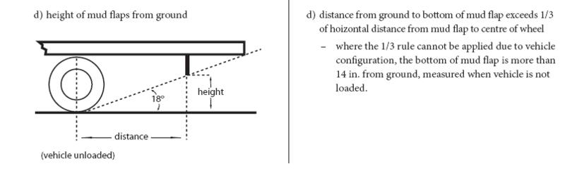

Any tire uncovered will fail, Mudflaps must be 14" height
Any bumper narrower than OEM will fail.

Originally Posted by MountainJK
The new regs.
i) passenger car
Extra bits...
Any extra exaust noise will fail if above an OEM decibal reading only.
If you drive off a road you maybe subjeted to a fine.
Welcome to BC... six Jeeps hit last week.
So much for being covered by insurance.
Where did you find this? I can't see these sections in the Motor Vehicle Act or it's Regs....
Or are these specifications on the inspection checklist?
Please provide a link if you can.

Vehicle Safety and Inspection Standards
http://www.vsis.ca/nxt/gateway.dll?f...LEZE:cvim_view
you must have a login

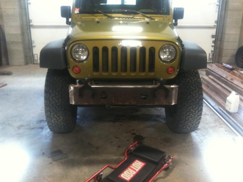

I got a warning for no plate on my front, due to being in the middle of a stubby build, and was told that it is twice the fine to have the plate displayed in the window. To my understanding the plate just has to be clearly visible on the from the front of the vehicle, am I wrong?? So confused:/.
Attachment of number plates
3.011 Number plates issued for a vehicle under the Commercial Transport Act or Motor Vehicle Act must be attached
(a) one plate to the front and one plate to the rear of the vehicle, if 2 number plates are issued for a vehicle, and
(b) to the rear of the vehicle, if a single number plate is issued for a vehicle.
[en. B.C. Reg. 279/2006.]
You could get dinged for Impropperly displayed plate and for Obstructed plate where if just failed to display it there is only one fine. But I'll be the first one to say that anyone dinging you for both is pushing it (Double Jeopardy).
