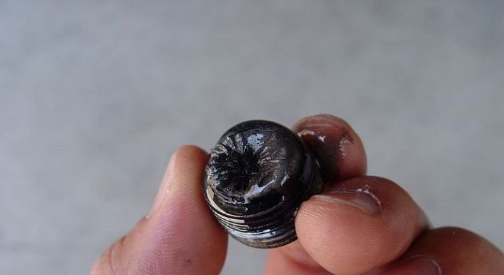

Step 2 – Inspect the drain bolt
The end of the drain bolt is magnetic in order to collect small metal shavings from normal wear and tear on the gears. If you find any large chunks attached, you need to remove the differential cover and inspect your gears. There is likely some damage. At the same time, you will also want to run a magnet through the pan with the old fluid to see if there are any large chunks of debris that came through the hole. This is an indication that you have some issues in the gears that you will need to have addressed and remedied. Before you replace the drain bolt, clean it up nicely with some brake cleaner and wipe it down with a rag.
Figure 3. Inspect the end of the drain bolt for any large debris and clean it up before reinstalling.
