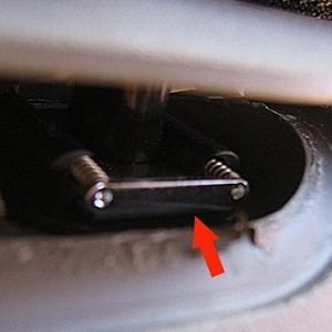

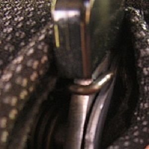

To remove the headrests on a 2-door, simple lift them up and push the buttons to release. On a 4-door, a few extra steps are required. Use a flat head screwdriver to push the spring clip off the base of the headrest post. Push the headrest down and locate the cutouts for the headrest release. Push down on the release and pull on the headrest to remove it.
  • Figure 2. Use a flat head screwdriver to push the spring clip off the headrest post.
  • Figure 3. Push down on the spring release to free the headrest.
