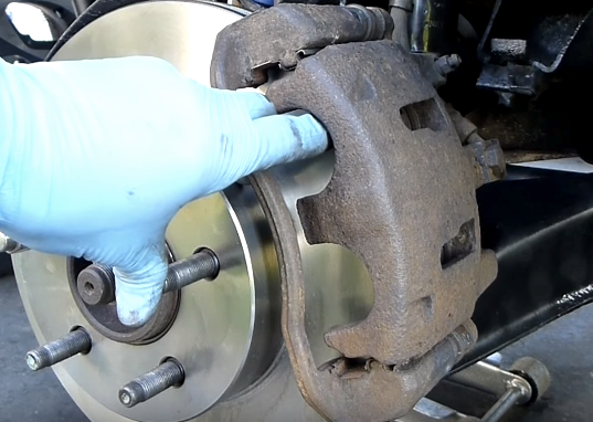

- Use a socket and ratchet to remove the caliper mounting bolts. The bolts are located on the back side of the caliper.

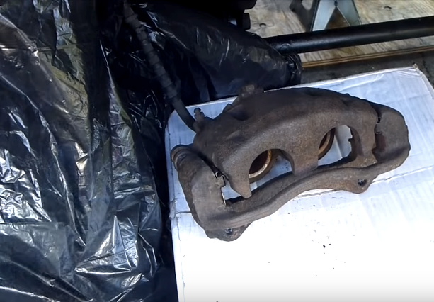

- Pull the caliper off and away from the rotor. Make sure to support the caliper using a bungee cord or box so as not to damage the brake line.
- To prevent paint from getting on the wheel hub assembly, use a plastic bag to cover it.

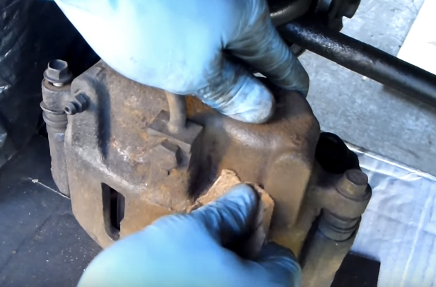

- Use a wire brush to remove rust and dirt from all the metal surfaces of the caliper. Take care not to damage the brake lines, the rubber around the guide pins, or the caliper pistons.
- Spray the caliper with brake cleaner, and then let it dry.
Figure 5. Remove the rust using a wire brush.
Figure 6. Spray the caliper with brake cleaner.

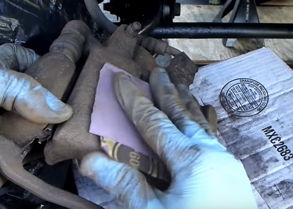

- Using a coarse 230 grit sand paper, remove additional rust or dirt from the nooks and crannies of the caliper.
- Then, smoothen the caliper's surface further using a finer 600 grit sand paper.
Figure 7. Use coarse sand paper to remove additional rust.
Figure 8. Use fine sand paper to smooth out the caliper.

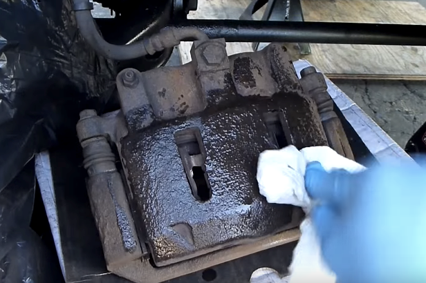

- Spray the caliper again with brake cleaner, and then let it dry.
- Lastly, use rubbing alcohol and a lint-free towel to finish cleaning the caliper. Make sure to let the alcohol evaporate before painting.

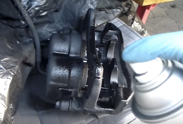

- Lightly spray your first coat of paint, holding the can one foot away from the caliper. Spray the caliper in smooth, even strokes.
- Flip the caliper over, and spray the rear side in the same way. Take care not to paint the caliper pistons.
- Spray an additional two to three coats of paint, allowing two minutes between each coat for the paint to dry.
Figure 10. Cover the non-metal parts with masking tape.
Figure 11. Evenly paint entire surface of the caliper.
