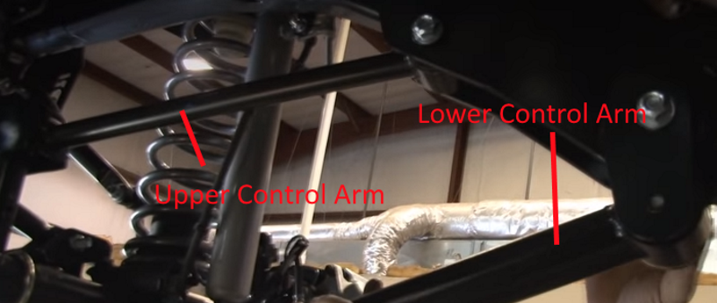

Step 1 – Remove heat shields over upper control arms
Remove the bolt holding the heat shields to the control arms. Pull the heat shield off the control arms once the bolt is removed.
Figure 1. The upper control arm heat shield.

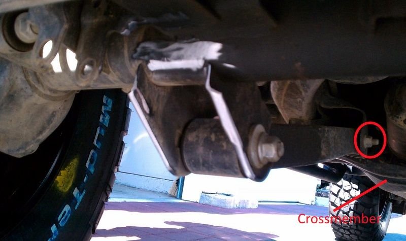

Step 2 – Remove upper control arm bolt
This bolt is too long to be fully removed with the exhaust installed. You can remove the exhaust or use a die grinder/pneumatic saw to cut the head off the bolt. Make sure a replacement bolt is included with your kit or have a new one ready. Also, make sure the grade or strength of the bolt is the same as the original. When removing a bolt that is tightened with a nut on the thread, remember to hold the nut stationary, otherwise the nut may spin in place and not loosen.
Figure 2. The upper control arm bolt.

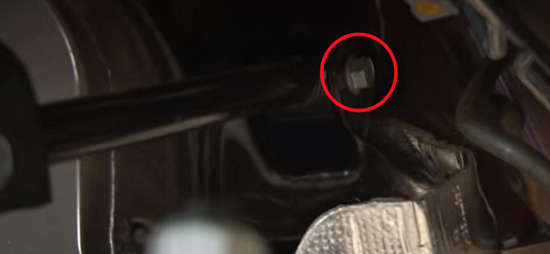

Step 3 – Remove lower control arm bolt
Remove the bolt using the same process used in Step 2. This bolt won't need to be cut.
Figure 3. Removing the lower control arm bolt.

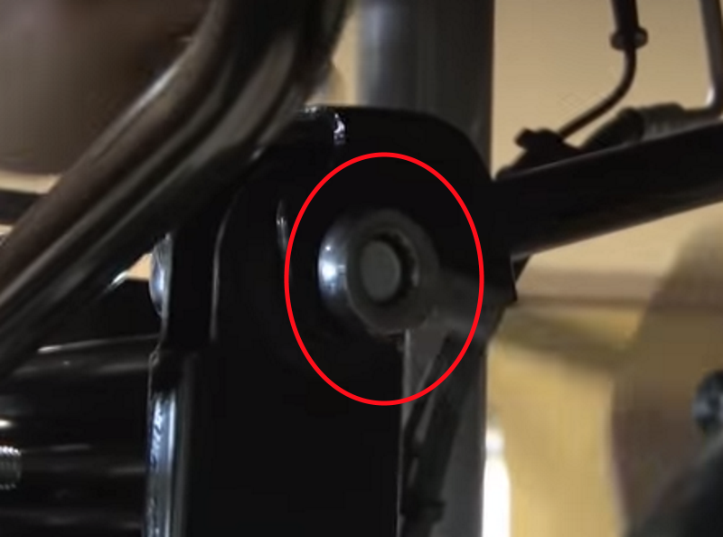

Step 4 – Remove second upper control arm bolt
Once removed, the upper control arm can be removed from the brackets. Get ready to install the drop brackets.
Figure 4. Removing the second upper control arm bolt.
