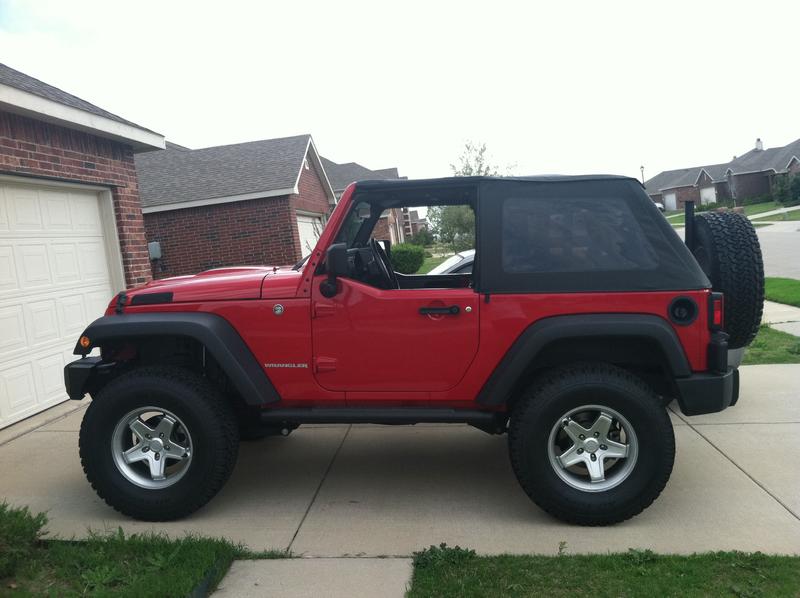

I use them with my Teraflex 2.5" coil lift. They did make the steering feel more solid, but the biggest difference I noticed was the improved braking. The front no longer dives when braking. They work well for my pavement pounder. I hit dirt trails every now and then and thats about it. I can't afford to break my JK as its my daily driver. I also enjoy driving a vehicle in good condition. They do hang down though as seen in my pic.
I went with the brackets because they were cheaper than control arms, require no maintenance, and worked for my needs. Not really sure why I chose the AEV brackets over other brands. I guess I did so based on good luck with their hood, wheels, and tire carrier. I would just go with the cheapest brackets you can find if going the bracket route. There is nothing special about them.
