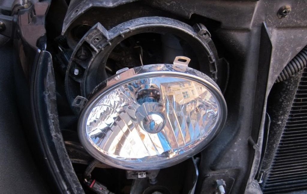

Open the hood and start removing the grille by prying off the plastic tabs along the upper edge of the grille. Pull out the grille from the corners. Unplug the turn signal lights and set the grille aside. Remove the four Torx screws around each headlight. Pull the headlight out and unplug the bulb from the headlight.
Figure 1. Remove the plastic tabs.
Figure 2. Remove headlights.
