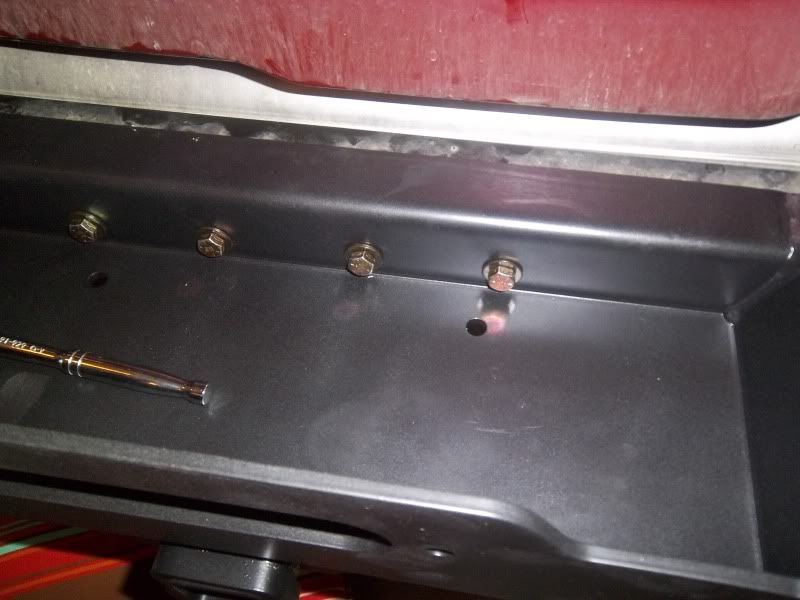

Step 5 – Bolt the bumper to the rear crossmember
This is why you didn't tighten the bolts on the frame yet. We want to get these crossmember bolts in first.
Figure 6. bolts going through the bumper.
