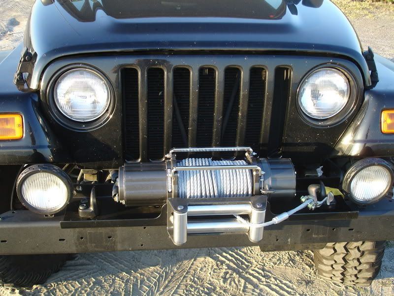

The Jeep Wrangler is designed to drive in areas away from any tow trucks. There is, luckily, an inexpensive solution sold by Harbor Freight tools specifically to get you out of trouble, which makes it OK to get in trouble knowing you can always get out of it. The winch has a cable that extends, which helps you in various ways. You can use it to pull other fellow off-roaders out of ditches, you can use it so fellow off-roaders pull you out of ditches, or you can even wrap it around a tree to gain more traction to pull yourself out of ditches. All in all, it works to allow you to continue the fun. Even though it may look like it's supported by the front bumper, make no mistake about it, it has no relationship to the front bumper. This winch is attached to a plate that attached to your frame, and it sits on top of your bumper without even applying weight on it. The process is easy to do, it just requires you to remove the front bumper. Read on to learn how you can install a front winch on your Jeep Wrangler and let the fun continue.

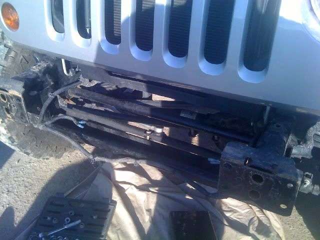

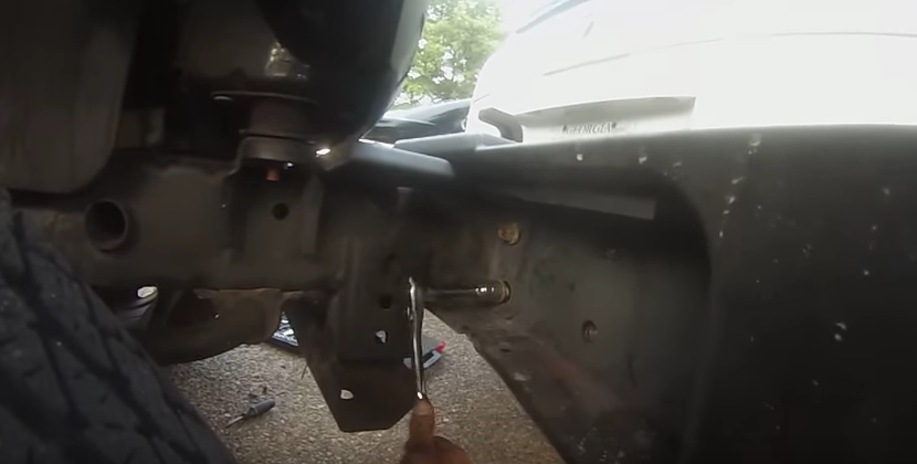

Remove the plastic shield from under the car. Remove the plastic clips by turning them counterclockwise with your flat head screwdriver. Slide under the front of your car, then remove all the bolts attaching the front bumper to the frame. There should be four total holding them together. Ask a friend to hold the bumper for you so it doesn't fall when you remove the bolts.
